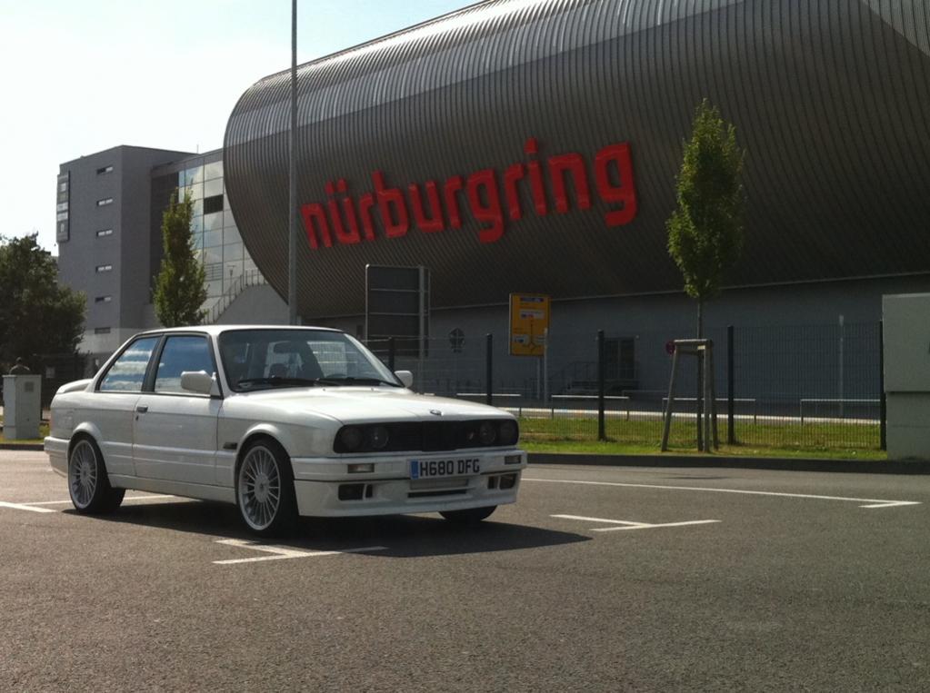

        Here's a pic of my car. Half way down on the adjusters front and rear.
        Housings sectioned 1"...
        Suspension tips here...
        http://www.r3vlimited.com/board/album.php?albumid=757

          Is that with or without the strut housings cut?
          • DRTSRFR
            • May 2008
            • 1836
            housings sectioned 1"...

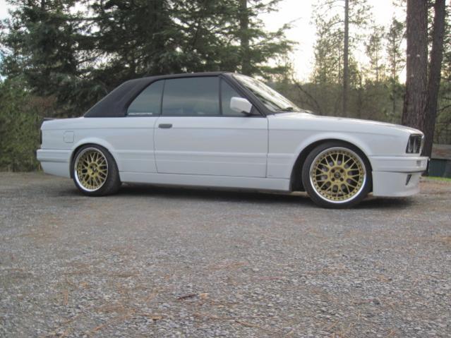

                Here's mine with stock housings (no cut). Spun all the way down in front with Kmac strut mounts and Bilstien shocks. Rears are spun almost all the way up.
