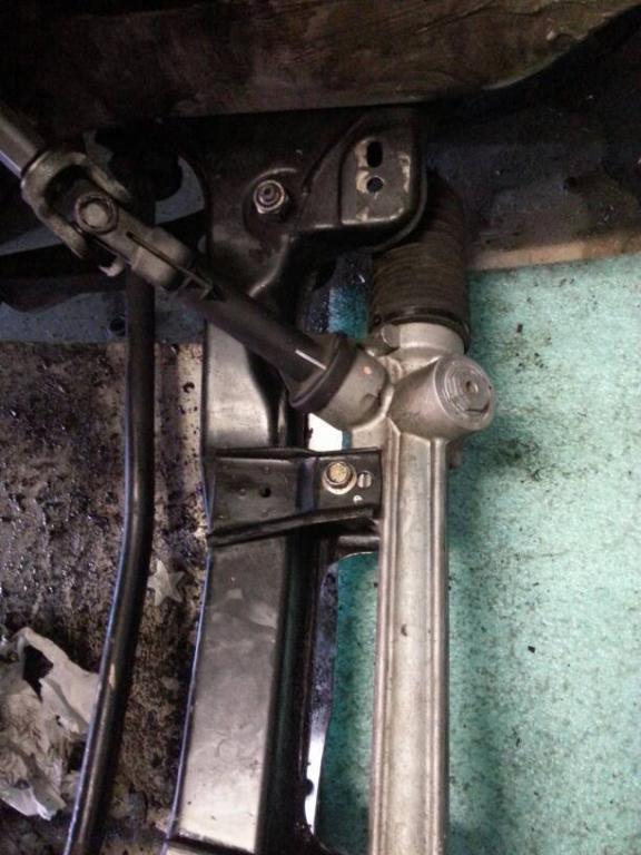

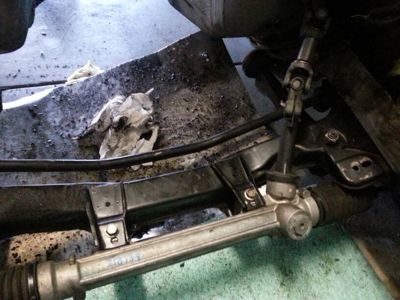

    Installed in our lemons racer; please excuse the needed for rules dirtyness.
    Z4 3.0 steering rack 2007
    Non powered steering.
    Z4 coupler must be shortened as spline diameter on z4 rack is too large for e30 original coupler. Chassis side of z4 coupler directly fits e30 steering shaft and original e30 steering column pinch bolt- clearance channel will need to be drilled in the shaft to clear the bolt.
    E30 . com rack mount spacers used to bolt to X . member: rest of kit un used so washers could also suffice.

      Ratio? Im not sure how to tell as bmw used this rack in 2004-2007 z4 cars with electric power steering assis mounted in the column. Lock to lock is 3.0 turns and seems like the angle is pretty good also.
      This rack cannot be hydrolic powered: there are no provisions for hydrolic in/out/ assist. It turns very easily with minimal resistance.
      The e30 is a 1987 non airbag but there is no difference for airbag or non when mounting the z4 non powered rack. The e30 u joint cannot be used at all as the z4 rack spline imput has a larger diameter standard than e30.
      E30 and z4 steering column chassis side is the same spline standard diameter and directly compatible. E36 tie rod ends are also needed as z4 tie rod ends do not fit into e30 knuckles.
      Z4 steering shaft connecter with u joints is telescoping on bearings; 2 piece unit much too long for e30 use. Just shorten to the needed length for your setup.
      No rubber bushing is good for low profile header clearance in case you want to run a v8 engine
      This is Ideal for one wanting to reduce to the minimal for efficiency and light weight racing setup. This car is only fired up to endurance race.

              Modifications are very self explanitary just need the z4 u joint/telescoping section. E30 tech spacers used to bolt rack to subframe

                            Has lots of angle. Its like a z3 rack but with more total steering angle: kinda like e36 328 vs m3. Needed to use it all the time to pull out of unintended drifts this weekend....
                            Can see inside of the rims at max angle; will post a photo. The steering feels very direct compared to our super sloppy original beat up wrack
