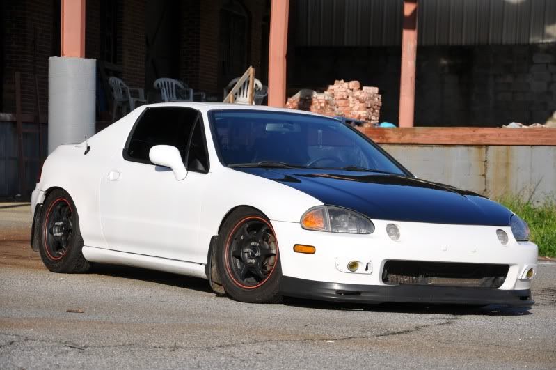

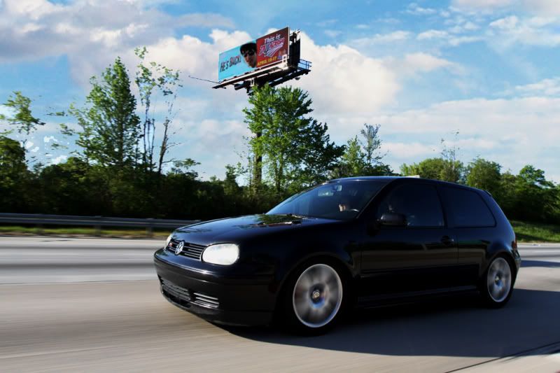

    Here are some of my other past vehicles for those who are curious.

          Nice looking wheels, BTW.
