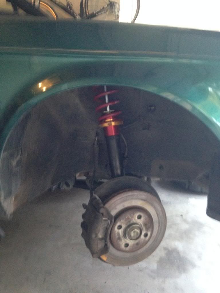

I've been running the GC coilover setup with the shortened front Konis for several years and have been very happy with them. If you can get the shortened front inserts and modify your strut housings you should. It's really nice to be able to have the car low and still have suspension travel.
Ground Control Coilover Sleeves + Koni

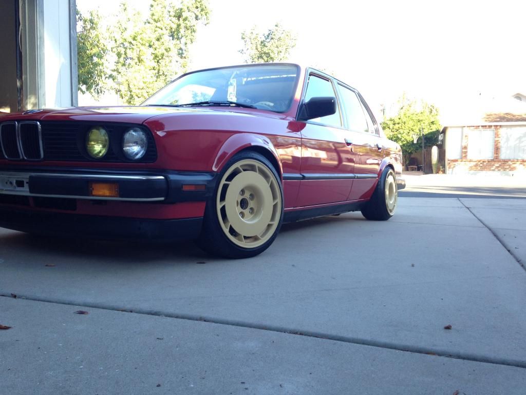

Hello guys...
I also interested with GC coilover.
My current project is disc brake conversion for the rear and vented front.
I'm still wondering the right ratio for 4cyl, in US gonna be 318is M42 engine for sure. In my place M40.
My e30 is my first DD car, and in my place the road condition is awful, bumpy + pothole (on rainy season).
I need some advice or suggestion for spring rate selection.
Currently finish remove battery on trunk, like a 325i.
It felt great for weight distribution, with most of them only me.
All interior in place, no audio+subs
this is my current suspension setup

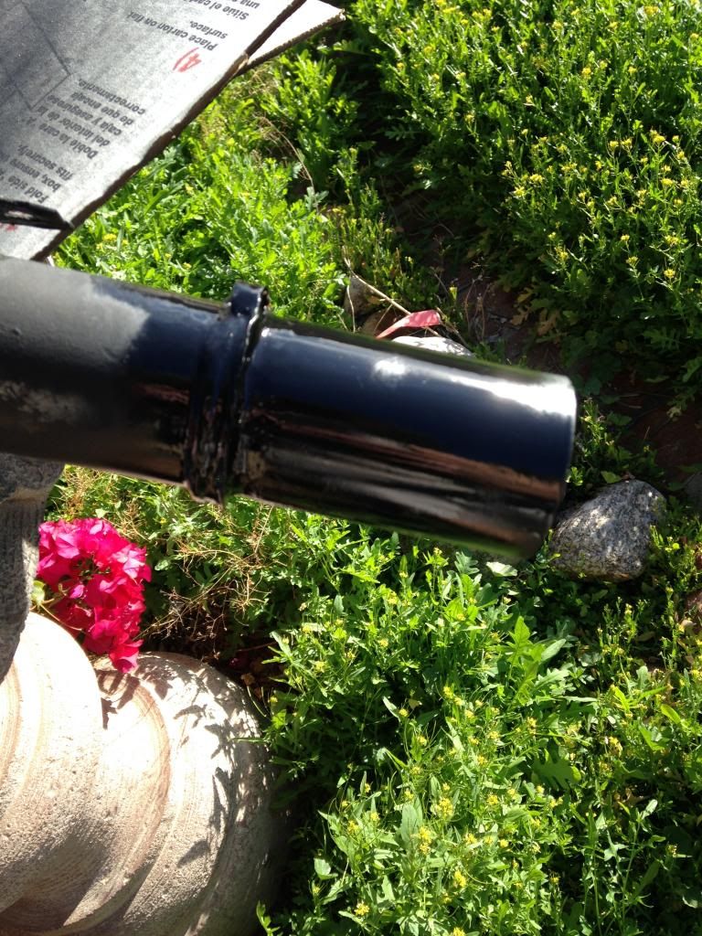

for shortened strut 1.5, will you use shorter shock insert g60 koni or keep it old insert?
do you have some pic of your lowest + highest ride height?
I need adjustable height for crappy road in my place[ETA - E30 Adapters] 5 Lug kit with e46m3 front and e46 325/328i rear brake setup
[ETA - E30 Adapters] - 5 Lug kit | DTM Shifter | DSSR
Transaction FeedbackComment

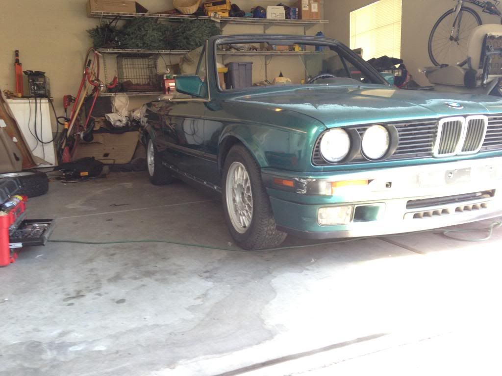

I was planning on using sw20 mr2 rear inserts. They are 4 inches shorter than stock e30. I don't have a picture of lowest height, but my signature is pretty low.2014 Alpine White 335i MSport
