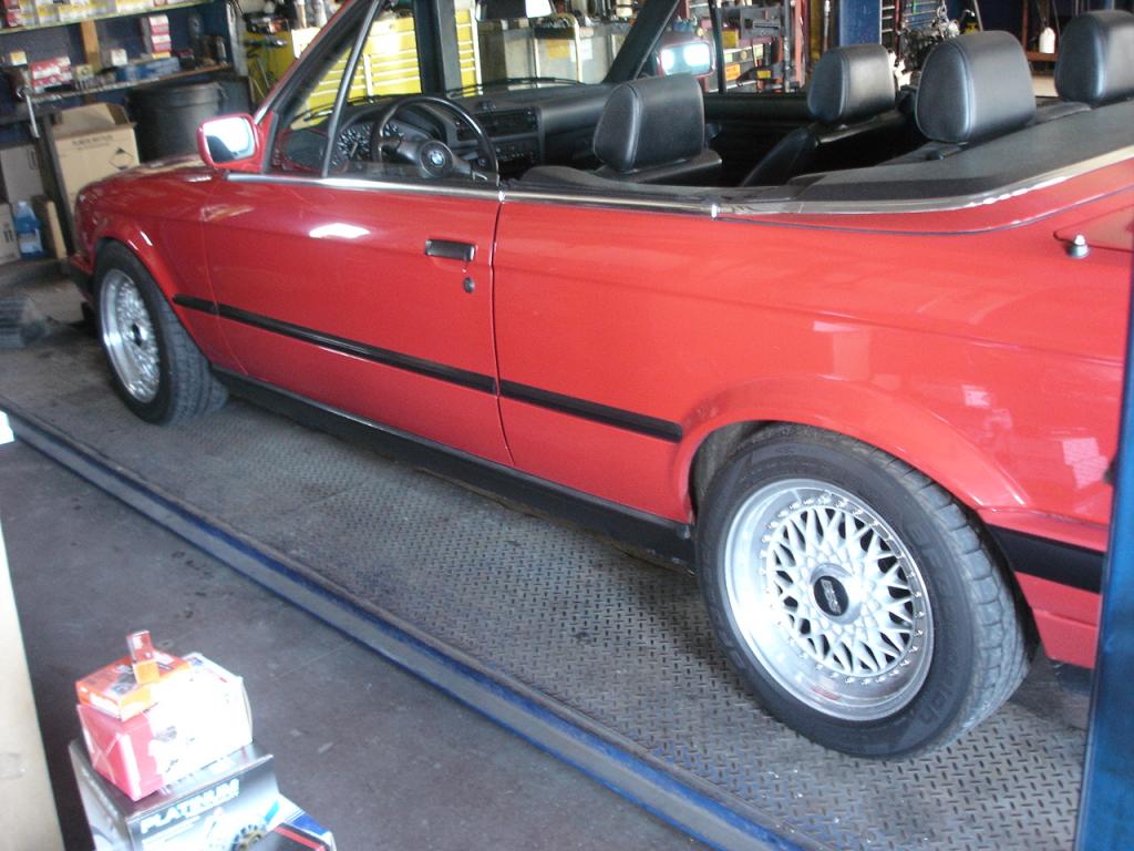

        I have a Bilstein BTS kit for a coupe in my cabrio, and it is excellent. Nice ride and sits just right!
        93 E30 325ic BrilliantRot M20B25 TCD S2+ GS637BZ CT3582R MS2

          ^ Man, that looks good! What are the wheel and tire specs?
