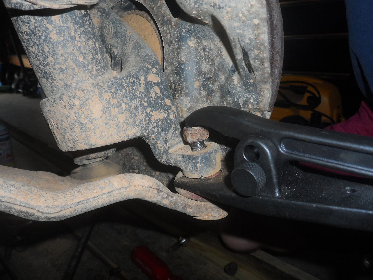

                I found that a ball joint separator (not the fork version!!!) from OTC or Harbor Freight and a GOOD spring compressor (bought or borrowed) is essential. I bought the one that autoparts stores usually rent out and it is much nicer than the ones that they sell but only costs about $10 more.
                Here is the ball joint tool:
                Here was my experience:
