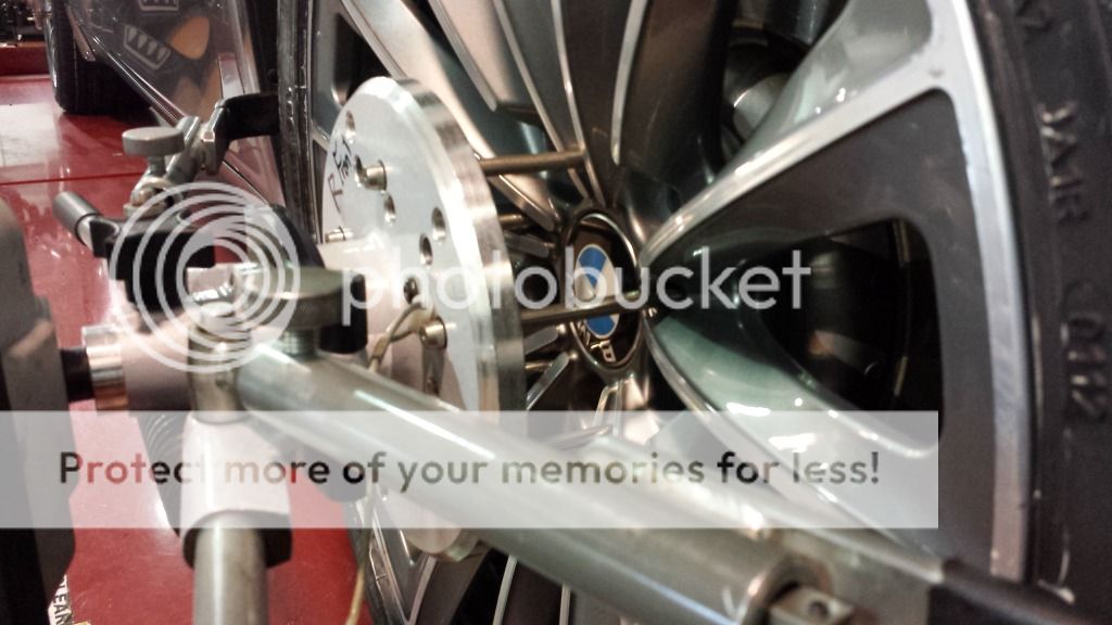

          Thats BS. But what he might thinking about is most if not all BMW factory wheels have little holes in between the lug bolt holes. Those little holes are where the alignment head pins go through so it is flush/anchored up against the rotor. Most side shops don't have this type of attachment and they attach their heads to the rim or lip of the wheel. Going against the rotor is more accurate, but if they use their stuff up on the rim I wouldnt be too worried about a toe adjustment. Maybe go to another shop.
          Im getting ready to align a F02 at work and I will snap a pic of our setup and post it up so you can see what I mean.

            Also if you have aftermarket wheels that dont have the little holes then you might be out of luck at a dealer anyways. The ones I have worked at didnt have any other way to attach the alignment heads to the car.

                the dealers mounting system I was talking about, but like I said it wont make that much of a difference for a toe adjustment. Could have been the weight issue also as jlevie said. Ive done alignments loaded down with sandbags, no sandbags and only sandbags in the driver's seat if they are the only one ever driving the car. Some people actually request it be done that way. Honestly Ive never noticed a big difference
