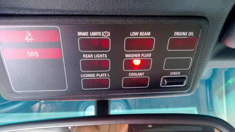

          I had the seller take a pic of the mil lights. It shows SRS. So that's how you know it had an airbag.
