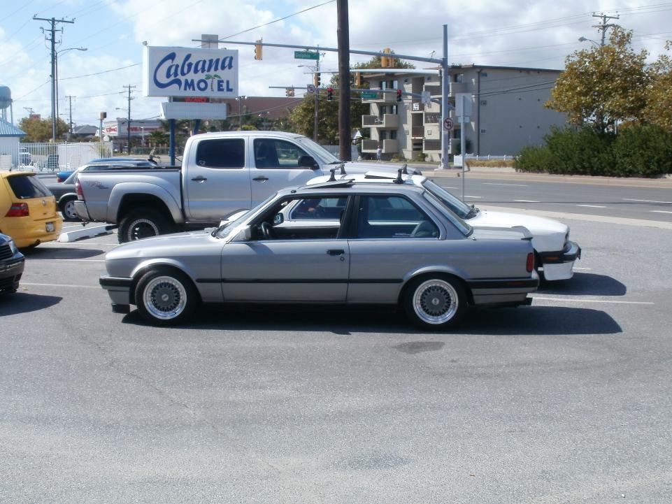

Here are a few examples of what I like
I had H&R sports on my last car but was thinking since it's a 318 they might ride different.
Would H&R Sports with the KYB AGX shock be a decent adjustable combo?
