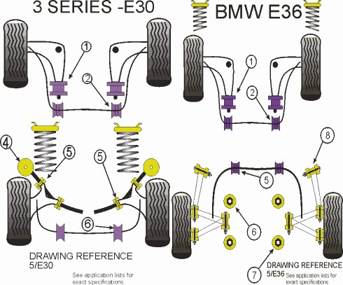

    trailing arm bushings. sway bar links (bushings included) Differential mount bushing..upper shock mounts and if ur feeling really ambitious... subframe bushings!!
    I'm doin the same thing in a couple months... all poly
    Check out the attached

      Can you explain what the numbers refer to? Yes, I'm a n00b but I like to learn :).

        • Simon S
          • Oct 2004
          • 3758
          flotsam & jetsam
          -----Zen and the Art of e30 Maintenance - / - Zen TOC - / - Zen Summary

            thx simon

              Thanks a lot for the diagrams. Made things much clearer.
