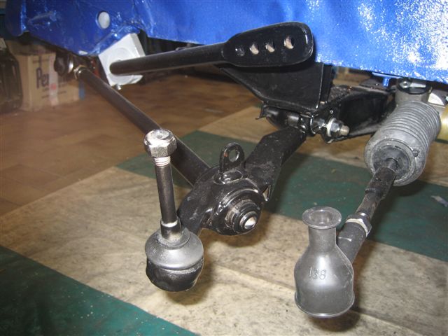

            • LJ851
              • 7919
              Originally posted by Roysneon
              I'm not familiar with e21's, what was wrong with it? I thought it was a lot like E30.
              The front suspension uses the sway bar as the radius rods (forward suspension link) It was not a good idea !

                • SkiFree
                  • Jun 2011
                  • 2766
                  This. It's also why if you ever see an actual competitive E21 the front suspension has been heavily changed. On a budget (or to stay within class rules) the band-aid to making it work ok is to shorten the suspension travel with pretty dang stiff springs or a dual swaybar.

                    • Bullet Ride
                      • Dec 2010
                      • 598
                      This looks like a relatively straight forward approach to the 'problem'
                      • SkiFree
                        • Jun 2011
                        • 2766
                        Yep, by changing the suspension so that the swaybar no longer acts as a radius rod works fine as long as you get the geometry on par (thought this would constitute as "heavily modified", maybe that's a matter of opinion).
                        The big caveat is that by changing suspension mounting points means you are no longer class-legal in most of the classes where an e21 would MAYBE be competitive. If you did go ahead and change the mounting points you'd have a fun track-day car or be grouped in with car classes where the e21 wouldn't be competitive.
                          I think you found that picture here?
                          http://www.e21build.com/2013/03/sway...t-options.html
                          Yup.
                          Most people aren't building their E21s into race cars, but it's good info to have in case you are.
                          I suppose for some people if you can't buy a kit off the shelf and bolt it on it's considered heavily modified. When I look at that all I think is fab a couple brackets, buy some bits and bobs, a little bit of welding and Bob's your uncle!
