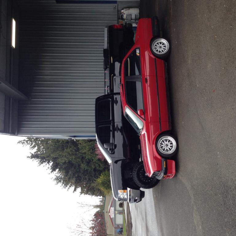

    Hey guys I have catuned coilovers and they ride great and the fronts I can drop to nearly the ground but my rear spring doesn't bring me as low as I'd like. where can I get some springs for the rear that will? & or what spring rates would bring me lower thanks here's a pic of my car currently

    shorter spring with a higher spring rate. You have an early model, so it hard to show how low they are.

      Early model will look higher due to arches in the rear being higher.
      Have you tired ditching the adjuster and spring pads?

        Already ditched the adjusters and spring pads

          looks nice as is.
