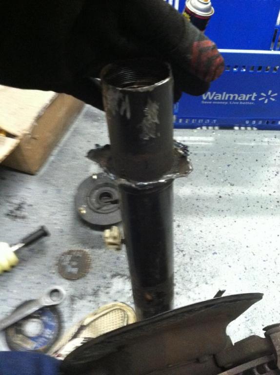

      My question is can I cut the stock perch and leave enough lip to run the gc on it and be okay?
      Absolutely, it will allow for more adjustment as well.
      Slide the red sleeve down to the bottom of the perch, then use a Sharpie or something similar to mark just outside of the red tube, then make your cut.
      Just take your time and don't do this...
          Did they cut that off with a torch or something? That is terrifying.

            I think they used Beavers...

              is that your pic? Were they able to salvage those housings?

                It's a customers pic.
                Ultimately, weld rings were needed.
