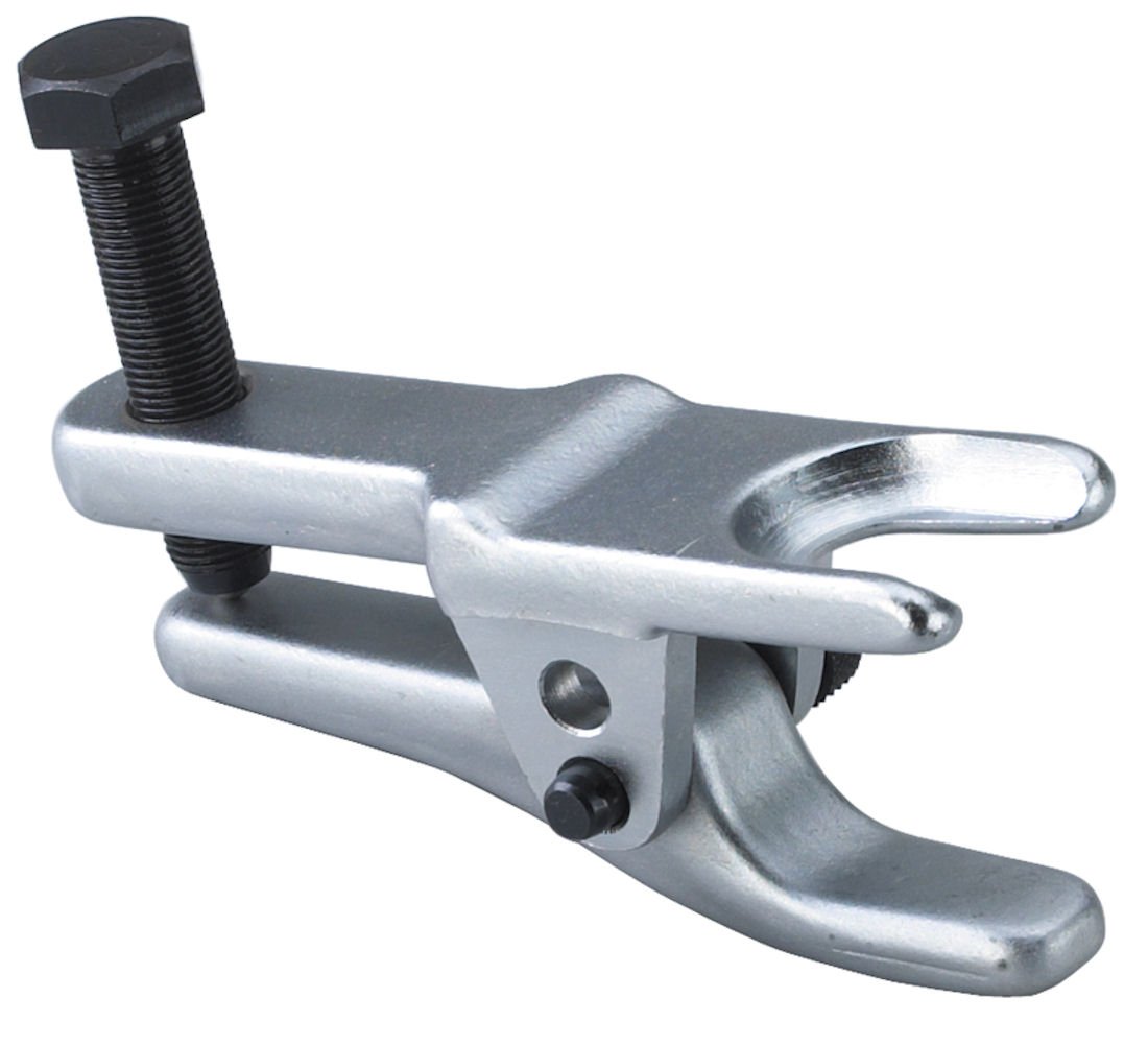

    You need one of these ! Make your life a hell of a lot easier with removing the control arms from the subframe and prevent you from animalizing the ball joints

      i have one of those, actually a couple. I'm going to try to just drop the center bolt of the control arms and hope I can get it all back in place when I'm done with the subframe. I'll take the steering rack down with it, and just pop off the tie rod ends.
      I've done more damage with the air hammer in the past so this time I'm going to try the OTC
        Interesting I've never destroyed a ball joint using an air chisel... Those work great too. usually use those for the tie rods and control arm ball joints to the strut housing. Works great but have to give it a good whack with a hammer sometimes to get it to "snap" out the Strut.
          A pickle for works great if you are replacing a tie rod or control arm, but they will destroy the boots otherwise. In this case disconnecting the inner control bolts (they aren't tapered) will allow the subframe to drop.

            I'm wondering if the outer ball joint on the control arm will allow the arm to move enough/the proper way for the inner stud to clear the subframe. I would say just take the tie rod end nuts off, and the inner and outer control arm nuts, remove the control arms and do it that way, still only 3 bolts per side, let the strut/spring/knuckle assemblies dangle for a while while you do the job.
            Also, the tool you have is 10x more effective and less boot tearing than a pickle fork. Forks are for old arms/joints that you don't care about anymore or cars that are being parted.
