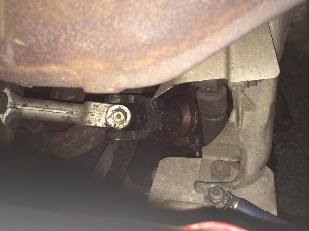

    Hey guys,
    Preppin for a close ratio steering rack conversion and had a look at my steering knuckle; it is different from what I see on pics on tutorials. From what I've read the knuckle has to be shortened from 275mm to 250 mm. To do this I could remove the guibo and hope that shortens it enough but if not, what would you guys do? Has anyone else ran into this problem?
    I did notice that the shaft on the rack doesnt seem to sit all the way into the lower uni joint, will that give me a bit more room to work with?
    The car is a 1990 318i RHD.
    Cheers!

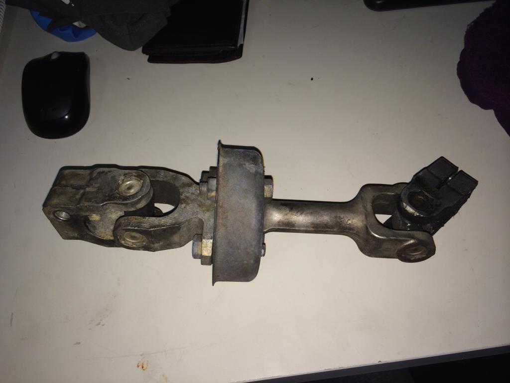

    Removed the cracked guibo and cover today, cleaned and lubed what was left.
    Still 6mm too long :(
    Anyone have any ideas?
    -Korbee
      RHD is totally different unfortunately. I've seen it done with stock parts and actually cutting the shaft on the steering rack. Not sure I like that idea. The other problem I was wondering about with just assembling them like above is you change the orientation of the unis, so I was wondering if it would cause binding problems.
      If space isn't an issue for you, I think this is just about the best solution I have seen used. Requires some machine work, but it will be an easy job to have a spacer made and tapped for threads. Also locates the unis in the same direction as stock.
      Just a little project im working on
      - http://www.lse30.com -
        Not sure about the RHD systems but the US systems have a splined joint in the steering column under the dash. There's a big nut that can be loosened and the column shortened or lengthened, similar to the driveshaft spline.
