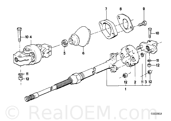

    Anyone know the BMW part number to item 5 ?
    I have been looking can not locate.
    Look like no longer available from BMW.
    Would like the part number to hunt one down, the boot{item 6] is not staying in place and item 6 is not there.

      Have looked at REALOEM.COM, that is where the posted exploded drawing is from.
      Item number 5 has no listing or part number.

          The part drawing I posted is for the 325iX{which is the model I have]
          Item 5 has no part number.
          Will try the part showing you posted for a E30 325e

            BMW P/N is 32 31 1 157 692. That Part number is for a 1991 318I. Could change for different years. My diagram was slightly different. It should be a similar part.
