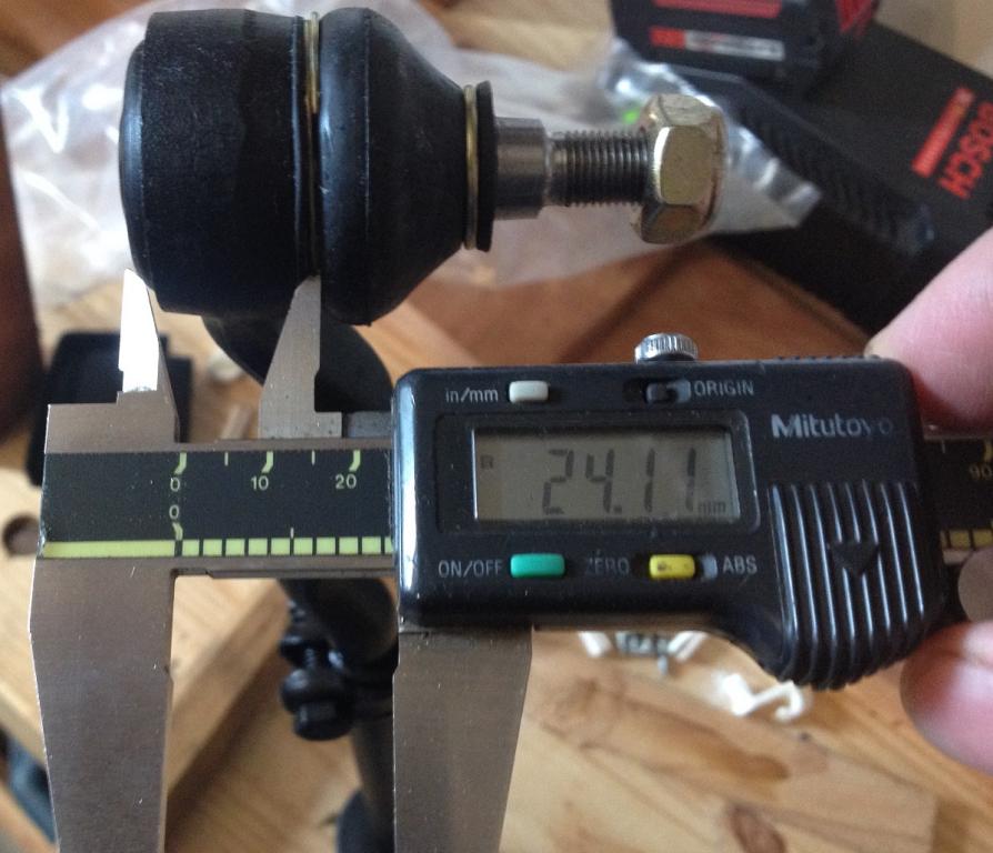

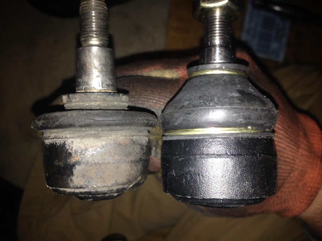

        1st picture shows OEM tie-rod end on the left, Karlyn on the right.

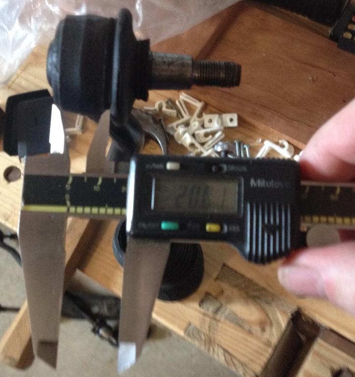

        2nd picture shows the approximate thickness of the OEM tie-rod end.
        3rd picture shows the approximate thickness of the Karlyn tie-rod end.

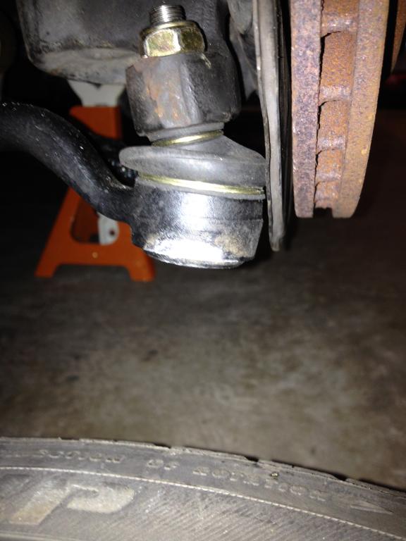

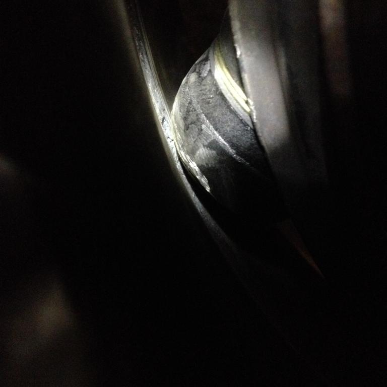

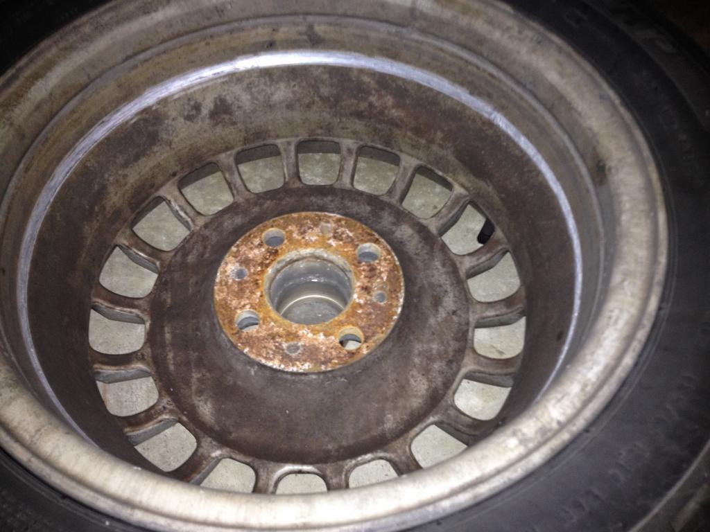

                An update for those wondering. As CoupeLX mentioned above, I was able to grind the tie-rod ends down and clear the wheels. Attached are the photos of the wheel once removed, showing the interferance between the stock 14" bottle-cap wheel, and the tie-rods in question. Then, there's some crappy pictures of the tie-rod ends after grinding. Last picture is shown looking through the wheel's spokes, showing the clearance between the tie-rod end and wheel, after grinding. It's close, but it works and the car drives SO MUCH BETTER NOW!
                Steve at Blunttech mentioned that he's sold hundreds of these kits, and has never seen this issue. I believe him. I actually work in machining of forged heavy automotive components, and while it's unusual, occasionally we'll see a forging come through that's a few MM thicker. Because of the tight clearances between the wheel and tie-rod ends, it wouldn't take much variation in the forgings to create a bad fit at the time of assembly. Either way, no fault of Steve's...
