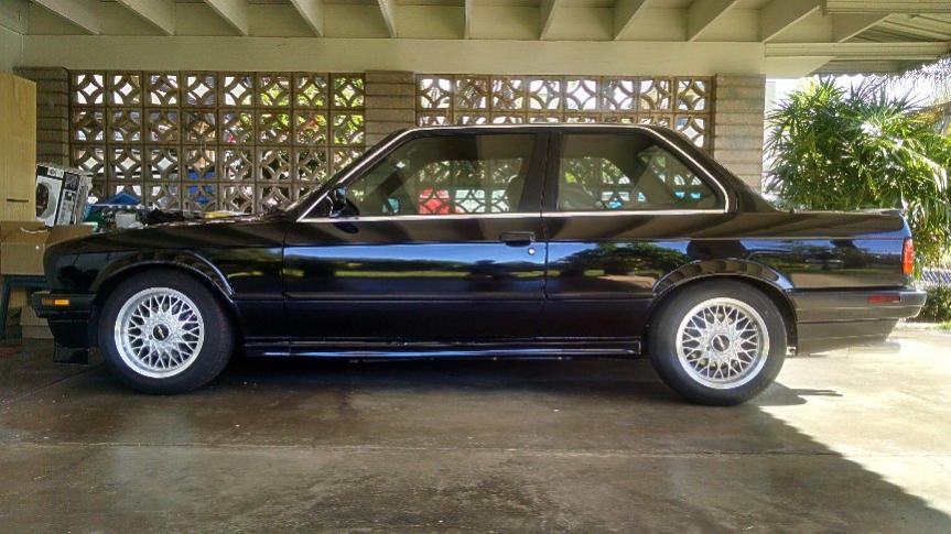

                    I just finished my suspension update on my 1990 325is. Previously I was on stock springs, KYB struts/shocks with 15 mm drop hats and with a 14.5 mm bar in the rear. Ride was OK but the car did not stick to the road as I was expecting for an E30. I was going for stock upgrade and not to low.
                    I went with H&R OE Sport and Bilstein HD struts/shocks. I went with 10 mm upper spring pad in the rear (vice 5 or 7.5 mm) and 3mm upper spring pad in the rear (vice 10 mm). I kept my 15 mm drop hats. The ride is good and the car sticks to the road. Surprisingly the set up is lower than I expected. Drop in the front is 1 3/4" (drop hats adding 3/4") and rear is 1 1/2". It looks really good, but it is low in the front so I have to be more careful driving.
