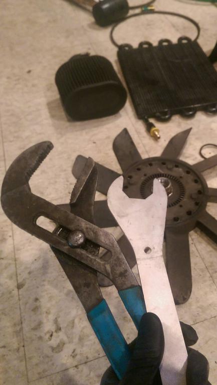

        Another question: if I'm trying to loosen the clutch fan bolt and don't have a pulley holder, can I loosen it by cranking the engine with a wrench held to the bolt? I assume that bmw engines aren't counterclockwise rotation
            remember the nut is left hand thread you can use a screw driver across bolt heads.
            If you use the wrench and crank the engine please post video

              Decided that attempting to hold the wrench against the force of the starter motor would probably induce a trip to the emergency room hahaha. New tactic: big channel locks. Held the water pump pulley, braced against the alternator. Took one good tap with my palm and it came loose. I know that the nut is reverse threaded.
