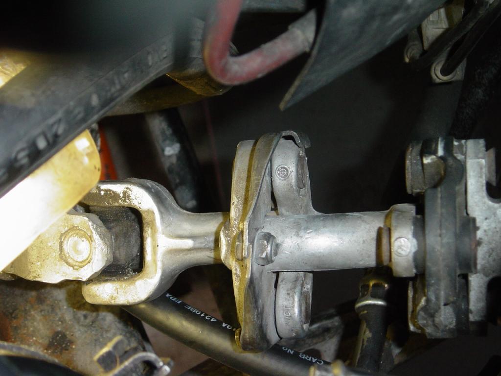

      Here's the joint in the shaft… those plates between sections seem kind of loose.

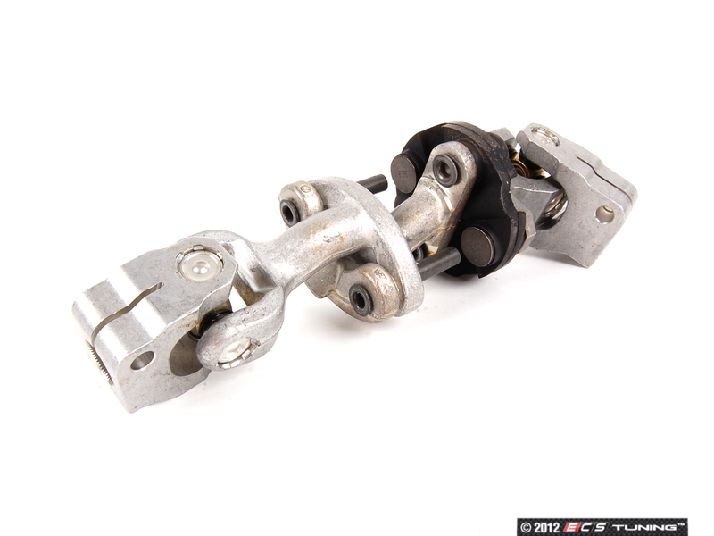

      Different hardware than this ECS coupler or what I see on realoem.
Name:	ECS coupler.jpg
