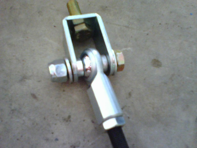

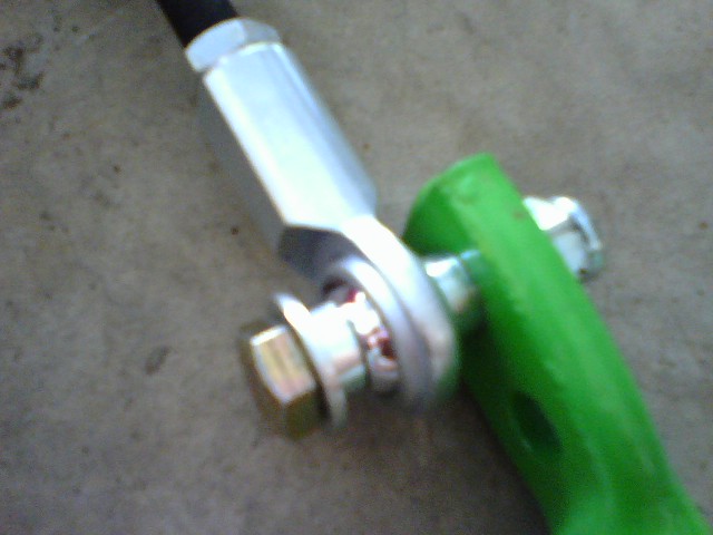

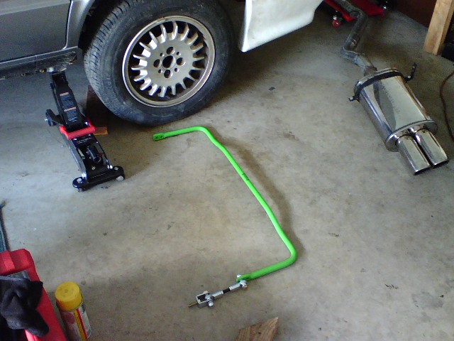

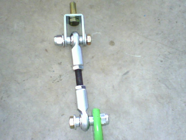

    Is this the way that the rear sway bar should be installed? The instructions are wack-ass vague and I'm trying to piece it together.... If anybody has any experience with this, take a look at the pictures (sorry about the quality, took them w/ phone) and let me know if this is accurate with the spacers/bearings and washers....
    I dont want this thing snapping on a turn. thanx guys!

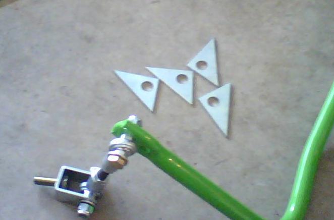

    oh yeah,, what the hell are those triangular metal slabs for?? I can't find where they fit anywhere...

    the tabs are to be welded in for reinforcements i beleive on the trailing arms
      correct, they welld in where the sway bar mount goes for reinforcements
        this is turner's kit, slighly different but shows you essentially what needs to be welded, there are instructions in pdf from this link too:
          If there are 2 of them in that picture welded as shown, then why do i have 4? it it 2 sides per control arm?

            Forget it, i answered my own question.. One above and one below the factory tab on the control arm... 2 per side... 2 sides = 4... math is fun..
            thanx for the help guys...

                Yo beej, is that 2 of them on top of eachother?

                  na, they just sandwich the original tab.

                    K, my question is answered, thanx alot guys. and great with the pictures. thanx beej.
