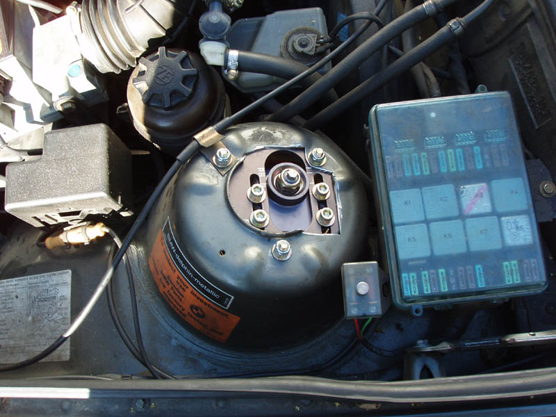

              I decided to take full advantage of the camber/caster adjustment. I overtrimmed on the end towards the rear of the car, but oh well..

                IS - Do you by any chance have your current alignment specs indication max. camber and caster after chopping your towers? Not that I'll ever do mine but I am interested in the benefits you guys are getting for the ltw shock tower mods.
                  Also curious. I could use some more caster.

                    I haven't had the car aligned yet. But I will let you know. I only have about a degree on the camber plates, which should give me 3.5 total in the front.
