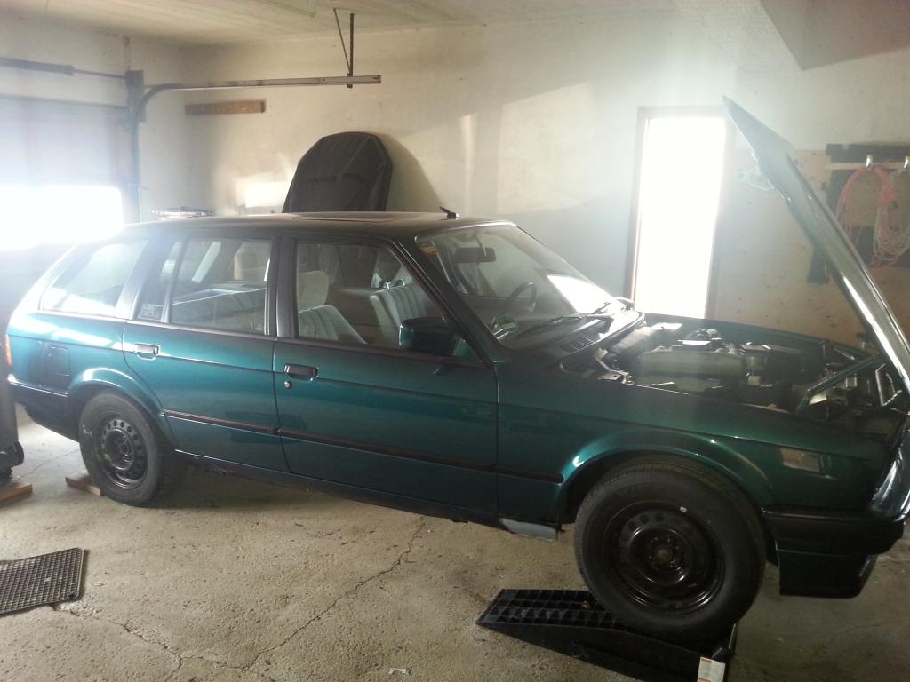

    springs and shocks for e30 318 Touring
    Hi everyone.I want to lower my e30 touring and I found out that the springs in the back are different from other e30 models.Can you guys give me some suggestions how to do it without have to order them from Europe.I would like to keep the back a little higher than the front.
    Thanks for opinions
