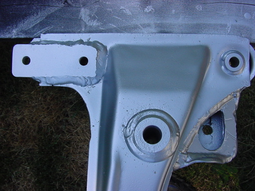

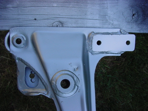

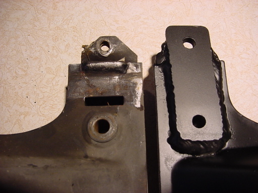

Thanks for the compliments. Here's the final build to fit the IE bars with my S52. Had to modify the holes for the motor mounts after installing Turner's reinforce kit to to the mount area to get the extra 1/2" span on the motor mounts. Just needed to open it up a bit so I could get a socket in on the mount with the new width. I have extra 1/4" thick SS pads cut just in case the swaybar wants to hit my exhaust. Ran out of black paint but I kind of like the silver since if I start to leak something it will show up on the lighter color paint. Also, I'll be running 1/8" pads between this and the motor mounts with a pair of shouldered nuts - should be a solid setup I think.Last edited by LINUS; 08-01-2006, 02:29 PM.
