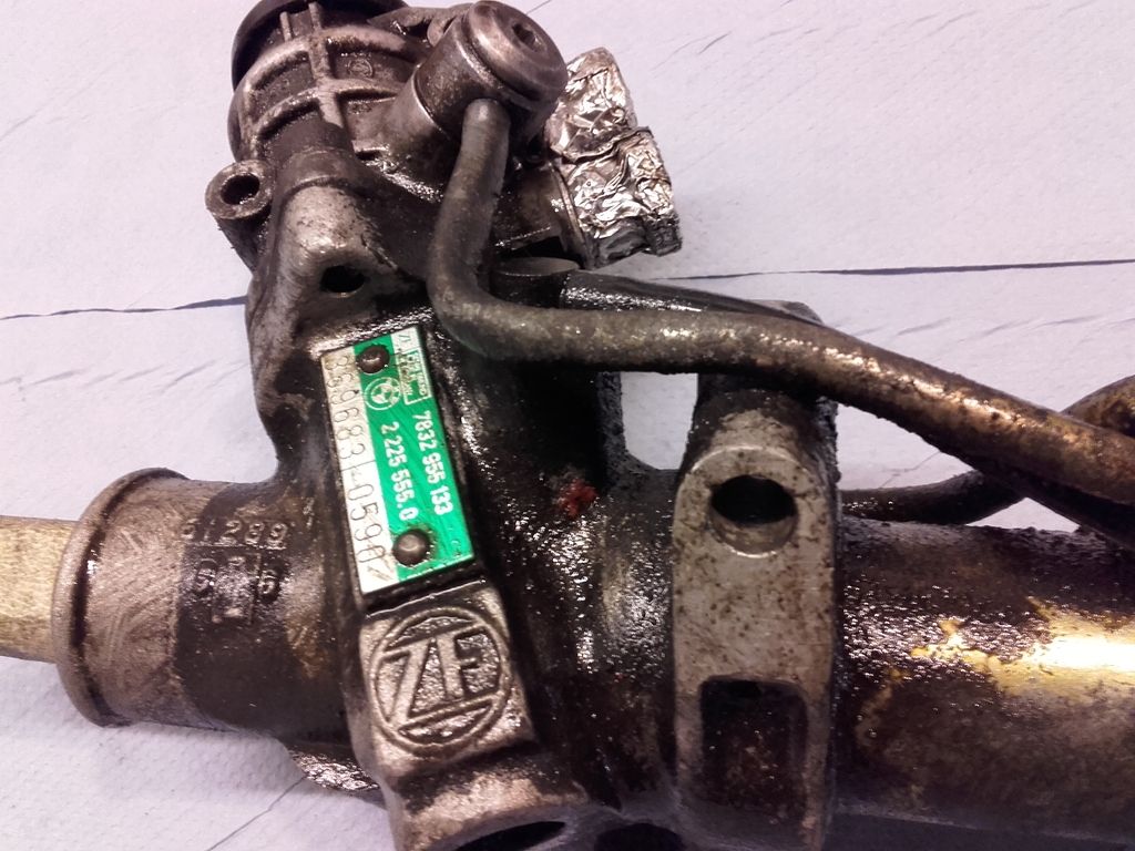

              Just completed the swap, here is my feedback.
              My observations:
              Not all E30 M3 racks have green identification plates; mine had a silver plate, note the correct E30 M3 part number (same number as on green plate). Only difference is production date on silver plate is 07/87
              Secondly, its hard to tell from the pictures, but the M3 rack seems to be a lot more heavy duty, particularly the pinion housing:
              One HUGE difference between the two is the way the racks are assembled, the E30 non-m uses a cast alum housing with pre-cast mounts. When a rebuilder rebuilds a non-M rack they cant mess up the mounting. This is however very different for the M3 rack because the rack housing rotates relative to the pinion housing, and must be reassembled PERFECTLY, or the rack will not mount as the holes will not line up.
              There is a big lock nut right where the pinion assembly and the rack assembly meet that can be loosened and mounting brackets adjusted (by turning the rack housing relative to pinion housing). You will need a punch to loosen and retighten this nut (if re-builder got it 1-2mm off).
              Another potential hurdle is the return power steering line that connects to the rack; in my case the line had been replaced at some point and was not long enough to reconnect to the M3 rack, this was because the M3 has 2 casting nubs that are very particular about how the hose is routed, wherein the non-m rack does not have these nubs.
              I suspect if the line were original this wouldnt have been an issue, and its something new 16mm ID line fixed easily.
              My feeling about the M3 rack vs non-m:
              I noticed a slight increase in steering effort, which is nice and gives for a better feel.
              The rack is marginally but noticeably quicker. At the points in a turn where you would normally cross over hands to continue turning the wheel. The rack feels more refined, wherein I feel I am getting to the edge of needing to cross over but not quite there.
              Overall pleased with the swap, and would do it again.
