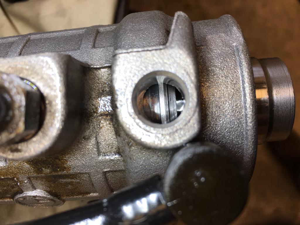

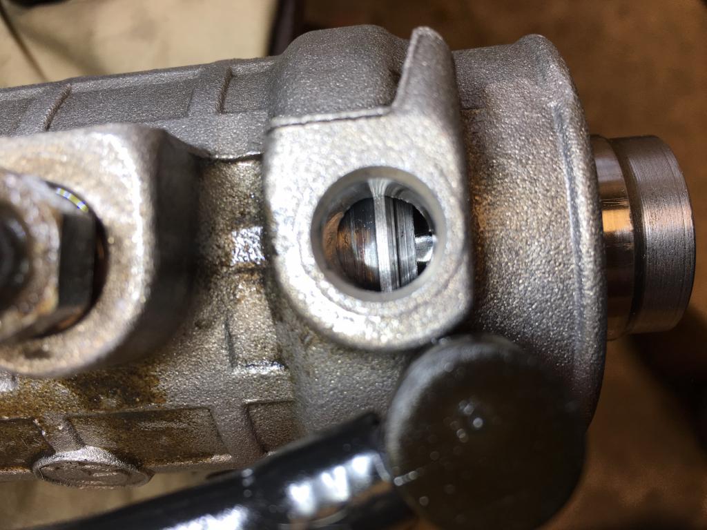

                  Last step of rack rebuild?
                  I've nearly completed an E36 rack rebuild/reseal and everything has been pretty easy. However, my last piece to install is the seal/bushing assembly (#25 on exploded diagrams) located opposite of the pinion side of the rack. The assembly slides on without any problem and appears to bottom out on the flange inside of the rack, but the metal retaining ring (#18 on diagrams) doesn't seem to fit into any machined groove. Also the view from the access hole seems odd....any thoughts?
                  • Ratcode48
                    • Jan 2019
                    • 3
                    [ATTACH]125097[/ATTACH]
                    • Ratcode48
                      • Jan 2019
                      • 3
                      Sorry, with images this time
