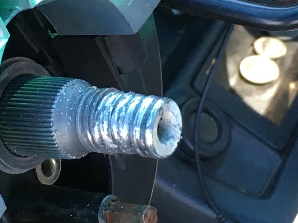

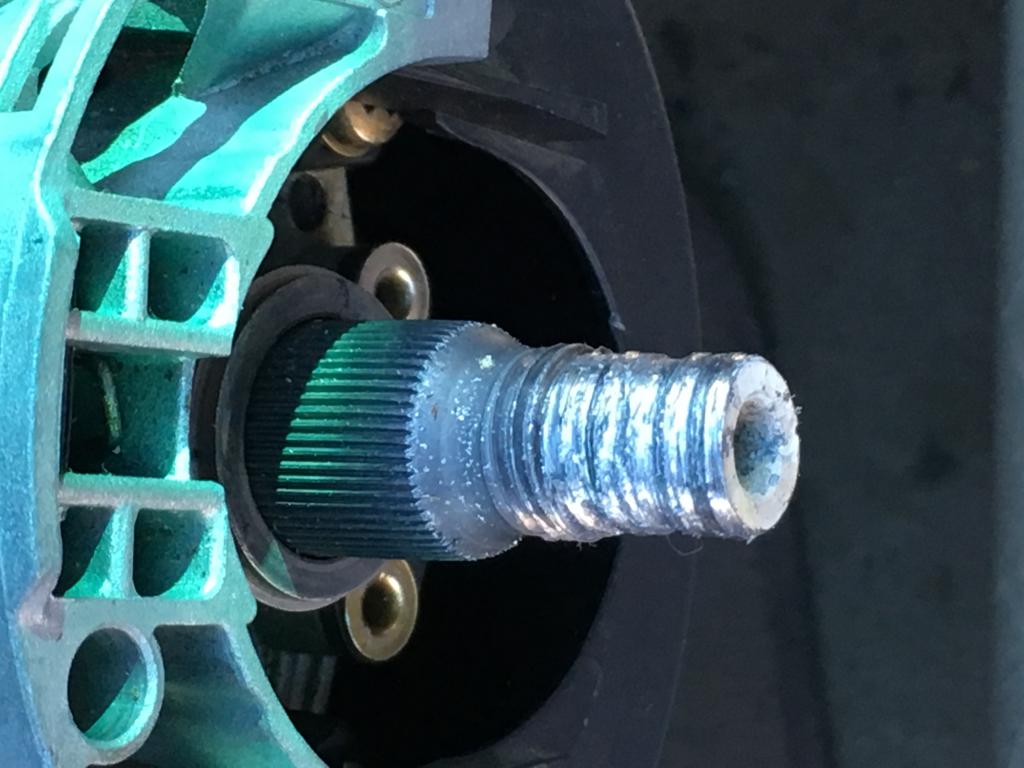

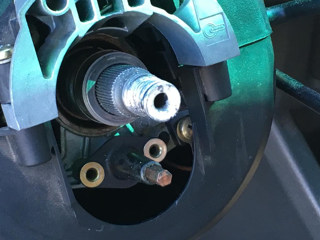

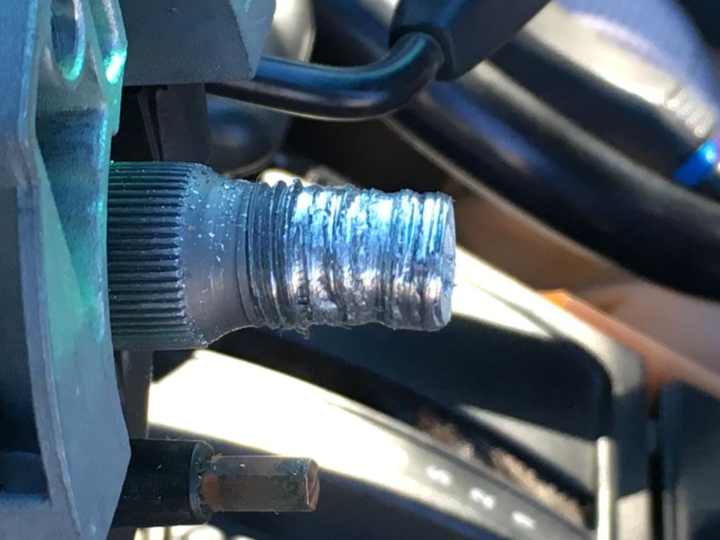

          So, there is a hole in the shaft - it's not a "pipe" with wall thickness but there is a center hole.
          I don't know that I'd say the threads are just "smeared" but take a look. They seem gone to me. Looks like maybe there's a bit of bend at the end from too much breaker bar to get it back off.
          Does a die cut down the diameter of a shaft? How would you mill it to a smaller diameter before cutting new threads?
          A lot of this damage was just trying to get the nut back off - it just spun.

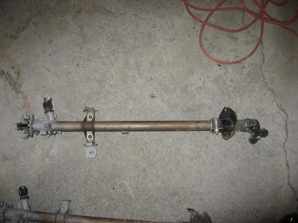

            What is the clamp at the firewall end of the column? What is it clamping?
            Do you replace the whole thing down to the fitting below the u-joint in the engine compartment, or does the column separate there at the clamp?

            • LJ851
              • 7918
              Damn, son.
              I would replace that shaft.
                    [ATTACH]115212[/ATTACH]
                    By clamp I'm assuming you mean the black 2 bolt plate. It's used to hold on a rubber cover. It acts as a flexible barrier btwn the cabin and engine compartement.
                    The part you need to replace is the column/tube. The part that connects to the steering rack is actually a splined shaft that fits inside of the column. It's held in place by a lock nut similar to the driveshaft. You can actually remove the lower piece that connects to the steering rack while it is in the car. SImply loosen the big nut (36m m or something) and back it all the way off. Then disconnect your u joint from the rack and you can pull the splined section out.

                      It's at the far right in that photo, before / above the firewall piece. On realoem it's #6, 32311115062 "clamp." It looks like it holds two sections of the tube together, with a sleeve over the firewall piece.
                      Just wondering if that's a better place to break the column, or go to that isolation pad joint just below the upper u-joint.
                      Thanks -
                      oh, EDIT......maybe the shaft itself doesn't break until the splined end goes into that u-joint. That makes more sense.
