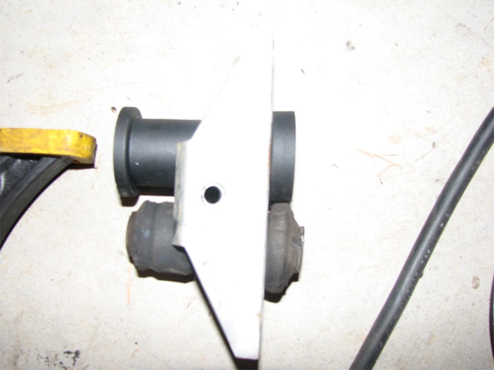

            i cant get it in with a fucking pry bar. and when i tighten the bolts the bushings are supposed to shrink several mm? hmmm
              the big end of the IE bushings is smaller then the big end of the stock bushings, which means the other side is too long
                pictures?
                  here
                    Does anyone have IE Rear Trailing Arm Urethane Bushings installed on there car successfully? This may just be a cause of a bad batch. Or like IS said maybe they need to be tightened like a SOB before they fit correctly. Did you try to contact IE and ask for there advise? If so I would like to know before I purchase the bushings.
                      doh!

                          i had the same problem. absolutely no way to fit them in without slicing off a little bit of the end on the bushing. the first side went in and was sliced on the bracket while making them fit together, the second one wasn' even close. i had to shave a bit to make it fit. either way it'll be better than before i figure, but i was very very frustrated during the whole install!!!!
