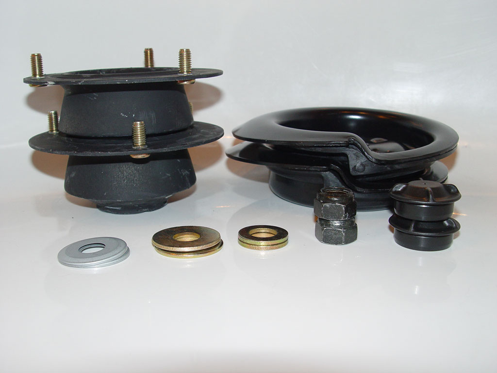

      so the washer goes between the hat and the bearing but i got 4.
      2 for each side. where does the other one go? nut side?
      Where? by jet jones, on Flickr

        Those washers are meant to be used with IE camber plates.
        Since you are using stock strut mounts, you will need thicker washers than that as seen in pic below (2nd stack from the far left).

          Goes:
          Nut #5
          Small diameter washer #4
          Upper strut mount
          Dust shield #7
          Large diameter washer #8
          Upper spring perch
          See here:
          http://www.realoem.com/bmw/enUS/show...diagId=31_0211

              I just rebuilt my struts and I can confirm, get those washers and grease covers oriented right. You can tell by feel if the washers make the bearing bind up.
              My only problem is that the original plastic bearing caps don’t fit my new top hats. I’m not sure why or what to do. I just put some gorilla tape over them as a temp covering.
