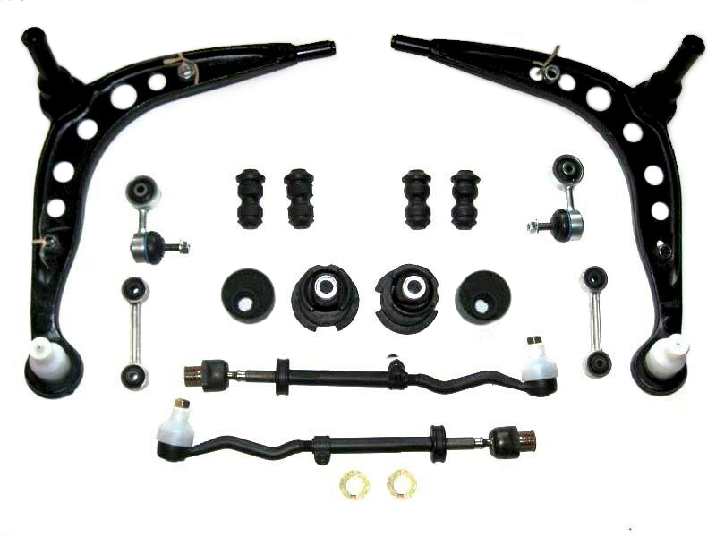

    So here's what I'm looking at (I haven't looked for cheaper prices yet, just made a list):
    ***For the refresh kit, I have some questions.
    1. Does this kit contain everything I need to refresh all of the suspension parts? I think it's just for the front. Is there a kit available for the rear as well?
    2. Is rubber the way to go, or should I do polyurethane bushings? I'm building a car for handling, so I think poly might be the way to go. However, will that make highway driving annoying? I don't mind a bit of NVH if it gives good feedback, but if it's just harsh, I'd rather pass. I will be using this car on the highway for longer drives semi-regularly.
    Am I missing anything? Could the strut/shock mounts be replaced now as well (if I'm planning a full refresh eventually)?
    I want to swap the steering rack eventually to something faster - would it make sense to do it now since I'm already going to take apart the suspension, or will I be able to bolt it in later?
    Finally, are other things like sway bar/strut bar/subframe reinforcements worth for weekend canyons and the occasional autocross?
    Apologies for the long post, I'd really appreciate some advice.

    1. No, the kit is intended for the front end. Other things that would be handy to replace during the front end rebuild would be the steering rack boots, the power steering hoses (if in poor shape), and the front strut mounts. The kit you listed uses the stock webbed control arm bushings, you can upgrade to the solid rubber centered 96-99 M3 ones, or offset e30 M3 & 95 M3 bushings if you want some more caster.
    If you want to get into rebuilding the rear suspension, new rear subframe and trailing arm bushings, new rear sway bar links & bushings (if in poor shape), and new rear shock mounts (either the OEM style with the reinforcement plates or an aftermarket style like Rogue or Ground Control).
    2. Poly bushings are usually easier to install, but for a street car, fresh rubber bushings will feel great without any added harshness (maybe soft poly rear subframe bushings, but that's about it).
    Other things to consider:
    If you're going to swap the rack, it's a good time to do it while you're refreshing the front suspension. You will have to notch the firewall on an airbag e30 due to the steering shaft angle, but even a standard e36 rack will make a noticeable difference (rackdoctor.net is a good spot to shop for a refurbished steering rack).
    The m42 engine has a low oil pan, so a skid plate is strongly encouraged (red46 or race skids are popular brands).
    If the differential has to come out, get a stud kit (Condor Speed Shop is the one that comes to mind), as it'll make install back into the subframe a lot easier.
    If you want larger sway bars than stock, you'll want reinforcements for the front and rear mounting points (depending on the brand, some are bolt-in, while others may require welding). A front strut bar can help a little, but not entirely required.
    Seems like you're pointed in the right direction. As long as the engine & drivetrain are in good working order, sounds like a fun car!

          I just did a revision on my earlier refresh and it’s made a huge difference. I basically did everything in the front end kit, except used E36 M3 solid CABs. Ran Bilstein B6 HDs on stock springs and sways, which cleaned up the ride but didn’t help height or body roll.
          I just finished installing H&R OE Sports and a 14.5mm rear sway with new end links, and it’s a very different car now, much more neutral handling and actually a smoother ride, exactly what I was looking for. I got about 1” drop from stock on the front and rear, which is noticeable but not crazy low and still within the tolerances of my HDs. If I did it again, I think I’d get E30 M3 CABs for the added caster. Maybe sometime in the future when I’m bored :)
          H&R Sports will give you about 0.25” more drop but the same spring rate as the OE Sports. At that amount of drop you should really get B8s to take advantage of the shorter rod length and appropriate damper travel. For me, I would go to Race before Sport to get some serious stiffness out of the springs...and a skid plate for the oil pan!

              Our kit consists of all Lemfoerder or Meyle HD brand OEM+ quality aftermarket components. Includes- control arms, tie rods, trailing arm bushings, sway bar endlinks, E30 M3 offset cabs, subframe mounts and locking tabs.
              is this a better kit then what OP posted? I am trying to get parts together to do a refresher as well.

                The kits are pretty similar except for the M3 control arm bushings and rear trailing arm bushings in the Blunttech kit (none of the latter in FCP Euro).
                I recently did mine on my 318is and ordered everything separately. Doing it myself I simply bought new "lollipops" with CABs (non M3) already installed (most of the other bushings were done without too much difficulty- said in retrospect of course!). There is a very good thread on M42club.com that walks you through it well (though I don't know how much DIY you are planning). http://www.m42club.com/forum/index.p...0790#msg130790
                I was tempted to go with mike.bmw's suspension set-up. I really admire his car/stance. My 15 y/o strongly advocated for H&R Sports and B8s..... I eventually relented, making sure I got the 318 specific parts, and was quite apprehensive about significant drop and harshness. I am actually quite pleased with the set-up (though I kept the original springs just in case!). Certainly not too low, and not too harsh, really (though I feel everything on my gravel driveway). Handling/roll is certainly better than stock, though I of course don't have any experience with mike.bmw's set-up- it is probably great.
                I went all rubber and am happy with the decision. The guy (quite knowledgeable) who posted the above thread had initially gone with lots of poly, reverted to rubber and was pleased.
