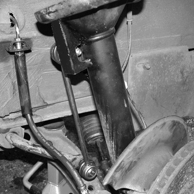

              A stiffer bar for $40.
              Made with .75 X 2" square tubing. Fits flush with inside of strut tube. This stiffens a stock bar quite a bit. All you ever get with bars is the OD. No quantitative measurement such as pounds per inch of travel or degree of body roll. I've also noticed that E30 owners have ideas about bars that are different than almost every other group of suspension tuners.

                  That looks pretty cool. So basically all i need to do is make the stock bar stiffer instead of getting a thicker bar.
