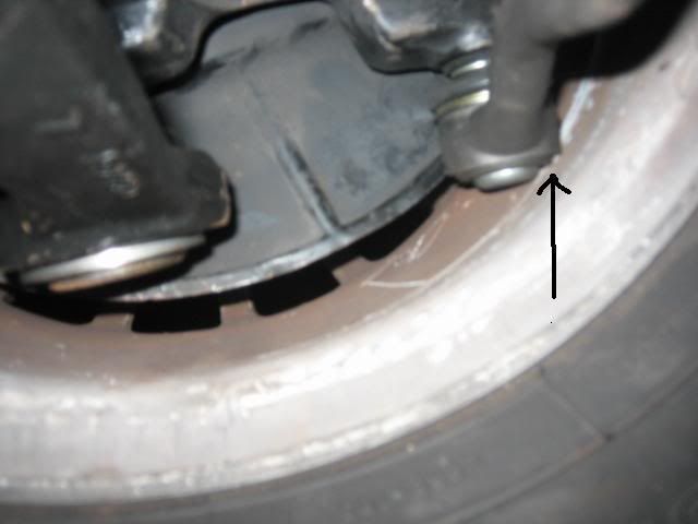

    driver's side tie rod touches inner wheel
    this is on bottle caps -- -- this sucks... doesn't happen on the passengers side -- haven't take the car for alignment yet ..
    should i just try to angle the bottom/knuckle out to clear ..?

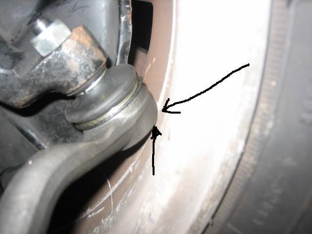

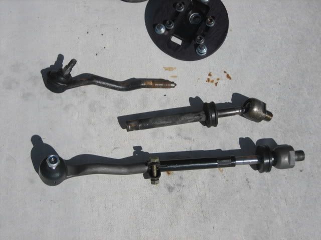

                  here are old & new b4 install --
                  after install

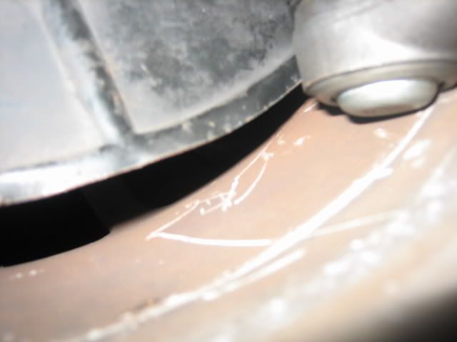

                  nasty wheel scrape

                    That's odd. I can't tell from the picture but is the "tie-rod" end the same size / height on both (old and new) ?
                    • PiercedE30
                      • Apr 2005
                      • 4220
                      it looks like the ball joint is larger than the old one......odd
                      you sure you got the right part?

                        Make sure the ball joints are teh same size.
                        Also, could the knuckle bent so the mounting for the tie rod is down too low?

                          The new one looks bigger. Did you make sure the nut on top got tight and did not just spin in place? This is common. Mine are close, but not touching of course.

                            Is the ball joint tight against it's taper on the knuckle? It looks like it might not be, but hard to tell. I think the Mike325 might be asking the same question. I put a small bottle jack underneath the joint when I tightened mine. Not enough to take the weight of the car, but enough to make it interfere with the taper on the knuckle.

                              From the pic i can't tell, but it seems the thread on top of your bolt is very little, try tightening it a bit more, but make sure you got the right part, sometimes the guy at the parts stor can make a mistake and send/sell you the wrong part.
