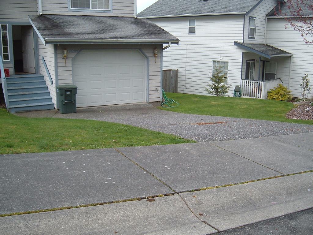

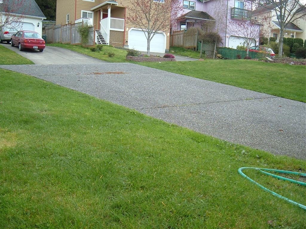

                also, speed bumps and steep inclines...how do the IE3s fare? Here's a picture of the driveway to my garage. I'm rubbed my "is" valence w/ stock suspension where it levels out when it meets the garage if I was going too fast leaving or entering the garage. Currently I have the m-tech 1 kit, which is getting painted right now, so obviously I don't want to set myself up for a situation where I can't even put the car in the garage without rubbing. With IE3s do you think going really slow that the pictured incline will be okay? I also have that rounded curb that leads up to the driveway to take into account.
                Sorry for the multitude of questions, but I just want to be very confident in my purchase prior to making it. One thing I like is a level look front to rear, in distance from the top of the tire to highest point of the fender. Will dropping 2" in the front and 1.5" in the rear keep it looking level? Thanks for all your help.

                  bump...need to make a purchase decision soon so I can get the suspension swapped before throwing on my new wheels only to find out that my car looks like a toy car w/ stock suspension. Do you think my driveway would kill my m-tech 1 kit w/ IE3s and Konis? Also, what other suspension components besides shocks and springs should I replace while doing the work?

                    Your driveway scares me. You just might have an issue with IE3's. H&R Sports would be a better bet, but even then without driveway modification it's a risk.

                        Thanks for the info man...I'll try to do some measurements to see what my driveway can handle. Fresh paint, so I can't bear to leave it parked on the curb...maybe I should just go with H&R sports and bilsteins..I would think they would be fine on my driveway. Thanks again.

                          Anyone else have any input about the proper springs and shocks given my ride height limitation due to my inclined driveway? Scroll up to an earlier post in this thread for pics of my driveway...

                            Driveway looks fine, just approach and depart at an oblique angle - you get used to it after a while driving ground-scraping cars.

                            • Schneider325
                              • May 2004
                              • 3818
                              that driveway looks like a peice of cake compared to mine! looks like you have a ton of room to come in at an extreme angle so you dont scrape
