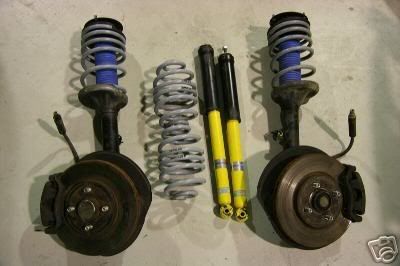

    I'm considering buying this set up second hand from a fellow BMW owner.
    1990 BMW E30 318is H&R Springs and Bilstein suspension
    I have for sale a set of lowerd H&R springs and Bilstein dampers. These two products are the most well ronound and best quality suspension components you can buy for your little BMW. As you can see from the pictures the fronts are mounted in the 318is struts. These struts are the larger diameter design, the same as the 6 cylinder models, as fitted to the 318is, but as the auction includes the struts they should bolt into any E30, including the 4 cylinder models. The springs are lowered 1.5" all round and greatly reduce the body roll, yet are comfortable. The dampers are the Bilstein sport models, that are firmer than the HD and are suited to the stiffer and lower springs. Both the springs and the dampers are only 8 months old, and have not been used for the last 4 of those months, i have reciept to confirm this. The auction includes the brake discs and calipers attached to the struts, ready to bolt in.
    i have no interest in the disks and calipers as he will not ship them interstate.
    questions are, does anyone have pictures with this set up?
    and is there anything i should know about these before i buy them?
    I can get pics if it helps.

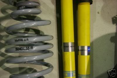

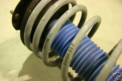

          The model numbers are as follows:
          Springs:
          Front: 50404.55 F
          Rear: 50404.55 R
          The model numbers on the dampers are:
          Front: F4-P36-0335-H0
          Rear: F4-B36-2027-H0
          The springs are grey, and have H&R S/A written on them, along with the model number.
          Can you tell me what to make of this information?
          I am awaiting a reply regarding sport/race/oe springs...
          thanks

            i think those are OE if they are grey, cause black is sport and red is race.

                Questions i asked the seller:
                -Are the H&R springs model specific? (ie: specifically 318i/323i/325i?)
                -Are the H&R springs Sport, Race, or OE springs?
                -How many k's are on the set up?
                -Do you have receipts for everything?
                -What happened to the car they were on?
                I believe the springs will fit any of the cars as they are on the 318is struts which are the same as E30 6 cylinder struts, i ordered them for my 318is, not sure whether there are different part numbers for the other cars. The springs are the sport springs. they would be lucky to have 3000 kms on them. Have reciepts for both the springs and the dampers. The car was hit straight in the front. nothing came close to touching the struts or suspension.

                    according to that link those are 325 OE springs.

                      Originally posted by smonkbmw
                      http://www.hrsprings.com/scripts/app...Find3&MakeID=4
                      great resource thank you!
                      You are right, they are definitely OE sport springs.
