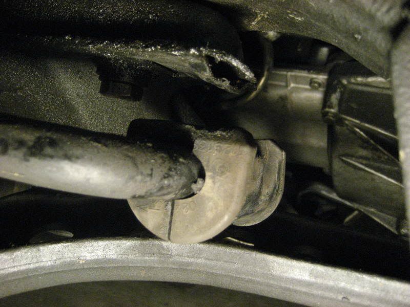

    this doesn't look right..
    Right now, the rubber piece can just rotate/move around freely, didn't seem right to me. I figured they were joined at one point in time or another..how would I go about fixing this? Weld on a new mount between the two? Any ideas?

    thats your sway bar bushing. it seems that your mount is gone:?

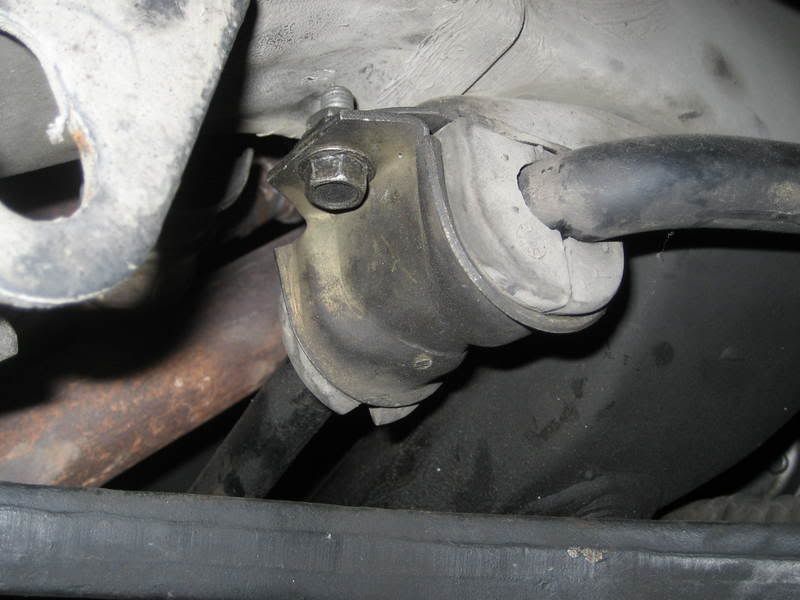

      take a look at your other side and thats what is should look like. unless they are both gone

        other side..
        seems good. do I just take it to a shop and have them weld up a new one to match the other side?

          it looks like you broke the end tab thing on your subframe so you might have some welding to do. how did you do that with stock sway bars?

            Bought the car on monday of this week, so I've been trying to get everything in working order before I start with the little mods that I'd like to do.

              im not exacly sure about the procedure and stuff but i think you will have to drop your subframe to get good accsess to that. you might as well get new bushings while your at it too. anyone else know what other parts are needed to correct this?

                You might need to drop the subframe. A good welder could get plenty of penetration from just one side, but you risk welding the subframe to the body of the car doing it that way.
                Personally, if you have any mechanical ability, I would drop the subframe yourself and take it somewhere to get welded. Should save a lot of $$$.
