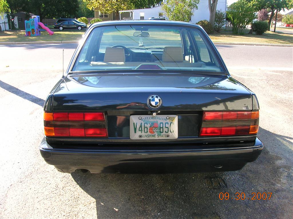

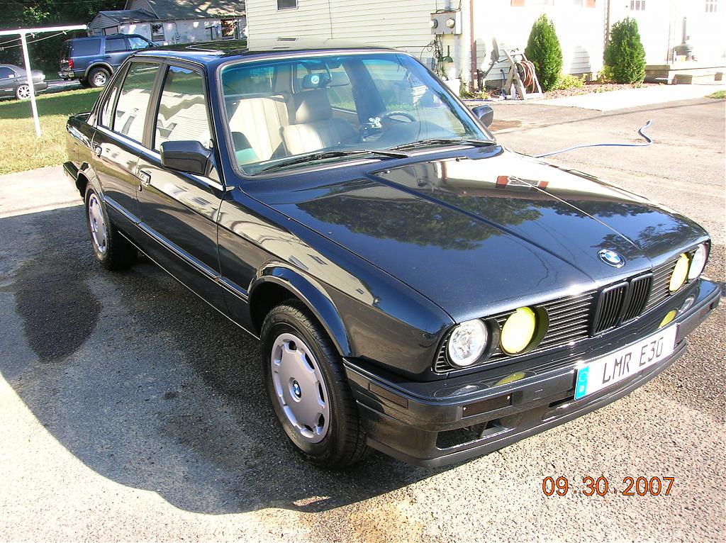

          Yeah its like a cross between a clunk and a rattle. I should have the motor and new rack back in it this weekend and will be able to see if thats actually the problem. Hope it is...this car has been stressin me out for the past year and cost me lots. I bought it for $350 and it was garbage. Heres a pic of how it looks as of a month or so ago before the rims/brakes/suspension/roof rack etc
