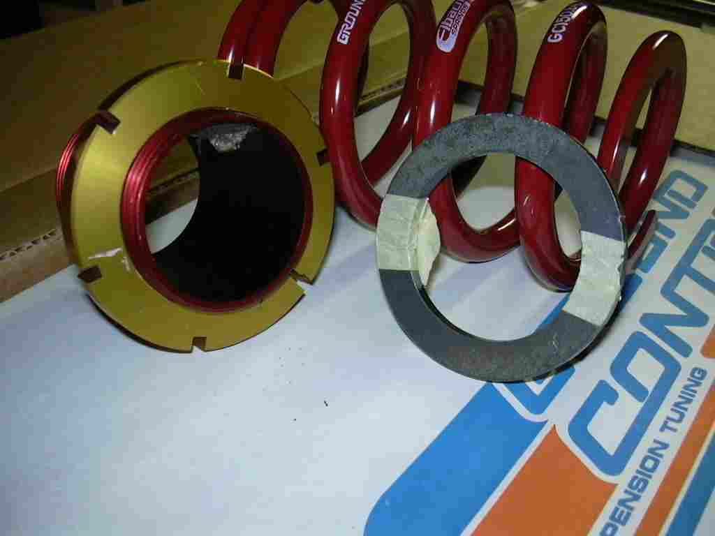

    After cutting down stock spring perches and leaving enough of the weld to hold the G.C. coilovers, do I need to weld this metal piece for the coilover to sit on that came with the kit? Thanks..
    DLM
    no, the weld will hold it just fine.

              I welded mine in and used the stock weld as the base for the welding. That way I would not have any issues.

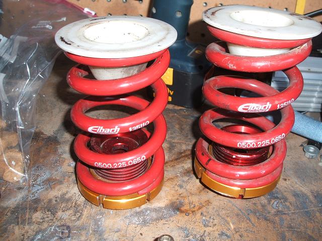

                More Ground Control Questions
                Very interested to see what the issue was and I have a few questions about the Ground Control Coil Over install.

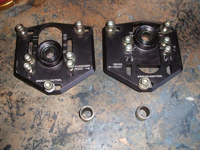

                Q3: With my set of Coilovers there were these 2 little sleeve /spacers *see first picture - that were included that appear to slide into the Ground Control Camber plates. My assumption is these can be used if one has a different diameter front struts shaft and should be used to take up any slop that would be present if the diameter of the shaft is smaller than that of the standard camber plate sphereical bushing. Am I correct and if so do these sleeve spacers go in at the top or the bottom of the camber plates when assembling?

                  The problem I had was the following. In the instructions listed by Ground Control they give you the option to cut the strut tower to give you full adjustment. With out doing this will not give you full adjustment on the camber plates. They give you a pattern to cut from. See picture of the sharpie marks and my cuts are inside. I aligned my car with factory bmw specs or as close as one could get. This is where the problem sits. The plates are meant to run a more aggressive negative camber. Me I wanted the option to adjust later if needed but chose a more stock setting. With this it puts stress in a area not reinforced by the strut tower. See pic1 above on right side of plate. Being aluminum and not steel, it lead to cracks in the material and not a bend. Total failure would have lead the strut to push through and into the hood of the car. Causing total failure of the suspension. (side effected)

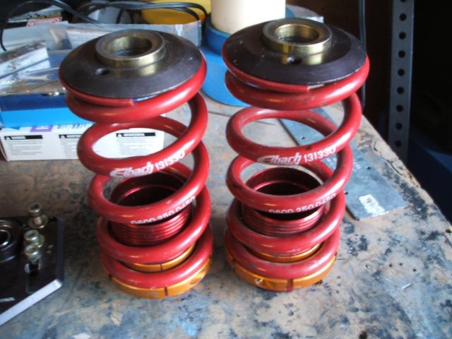

                  I contacted Jay though the GC website and asked him if they had, had this problem in the past. The answer was no. They worked that day with me to come up with a solution to correct this. Hence the backing and top plate shown in Pic2. This is designed like their E36 style setup. Reinforcing the top and bottom of the camber plate. They made and sent this to me free of charge and next day air. Jay at GC was super helpful and as fast as I could email him he was emailing back. AMAZING customer service by GC in my book.
                  The only issue is the top plate sould be cut a bit to allow full adjustment. Something that a dremel could do in a matter of minutes. This is the picture I can not extract from my camera at this time. Now I am running a more aggressive camber and will have it to the alignment shop in the following days due to a failure in my steering rack! SUCKS!

                  The pieces that you speak of is the spacers that drop down the strut tube to allow proper fitments of the shock and collar of the spring perch. I thought this was odd myself but it works well. I have not had any problems with them. The strut tube is longer to the shorter shocks used in the front of the shock tubes.

                      the plates should be added if you cut the STRUT TOWER, not the tubes. If you do not cut the tower then you will not need to add the extra backing as pictured above. According to Ground Control themselves. The spacers in your picture are used if you do not cut your strut "tubes" They go in the bottom of the strut tube before your strut goes in. Then build from there.
