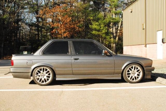

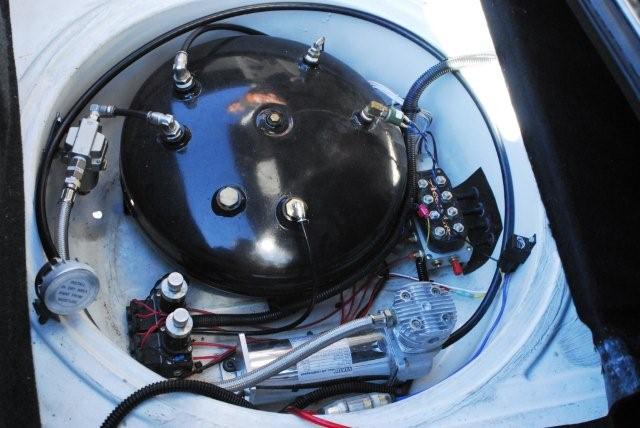

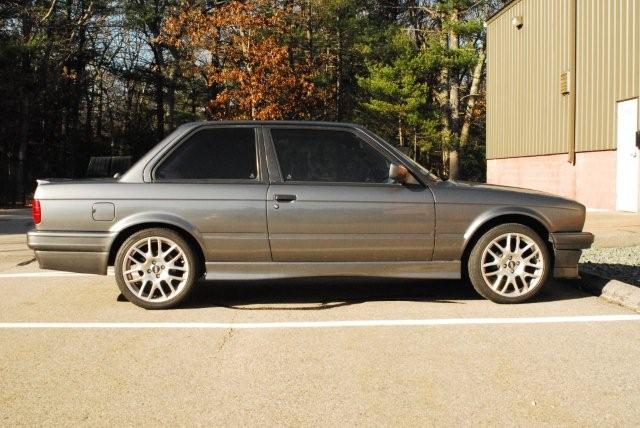

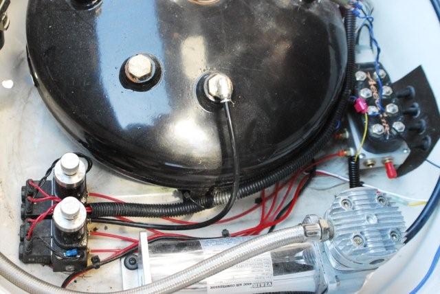

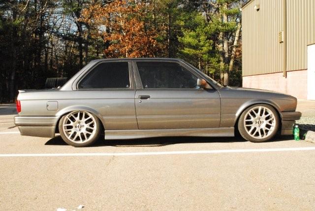

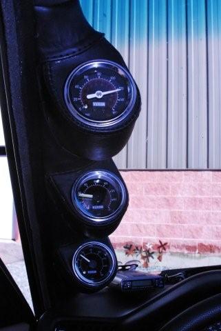

                  Here are some pics of 3 gauge pod we made, controller, 3 different heights: ride height, too high & lowered. We need to lower the front some more so after the new motor goes in well see where she sits.

                      Very cool stuff man, I like the leather wrapped gauge pod. And the Switch placement is good aswell.

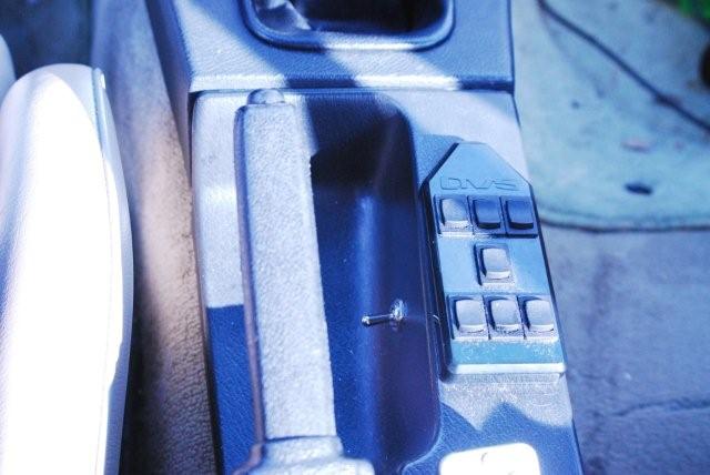

                            #88
                            Originally posted by E30SPDFRK
                            I'm not sure if this would work, but if you could use a two position switch (not sure if that's what its called) like the defrost switch to control up and down, it would be awesome. Have the in position to drop the car and the out to raise it back up.
                            This is a switch box rf/lf/rr/lr up & down middle switch all up & all down
                            middle top row front up/down & middle back row is rear up/down. The toggle switch lets me switch from automatic ride height control (Fab Lab) to the switch box.
