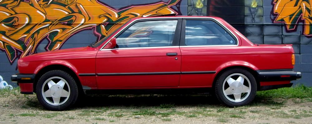

    Here's my old 325is with stock ride height.

      Your best bet for cheap, lower and a bit stiffer is e30 M3 springs. You can usually get them pretty cheap and they will go right in place of the stock e springs.
      • golde30
        • 11464
        just go with vogtland springs. they are like eibach pro-kit progressive springs, just a lil stiffer than stock, and lowers about 1". and they are fairly cheap ~150
        IG: @Baye30
        • Lair
          • Apr 2006
          • 1553
          I replaced my girlfriend's skyrider convertible front springs with is springs, and the car dropped at least an inch.
