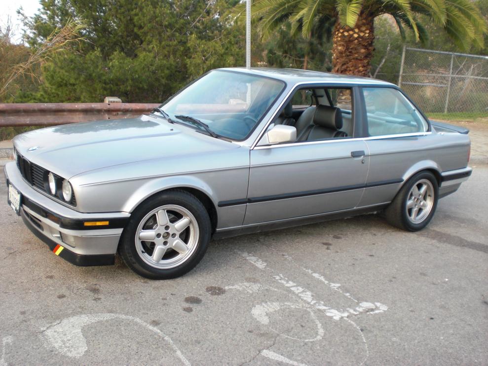

                      One last suggestion., I just got e36m3 stock springs put in the rear and eibach springs with adjusters in the front to give it that clearance whenever I want it, the ride is comfortable, not too high, not too low and stiff as hell, cornering is so fun, I also kept my HD billys.
                      Here's the stance, hopefully this isn't monster truck status for you.
                      @IRON-E30 aka Edwin:D

                        ^^ That is a prefect stance. What adjusters are you running in the rear just gc's or some custom ones?
                          Well I think my tires actually do the job in the rear 225/50/15's
