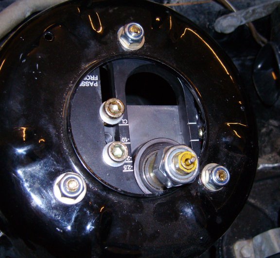

                      Also the geometry on the "knuckles" is different. (the strut geometry is the same) If you use any e36 knuckle on an e30, especially an M knuckle, you need a camber plate that will slide WAAAY back to prevent bumpsteer from rearing its ugly head. This is because the angle tilted rearward on an e36M is much more than any e30, so to duplicate the geometry to avoid bumpsteer, you should mimic the angle as closely as possible.
