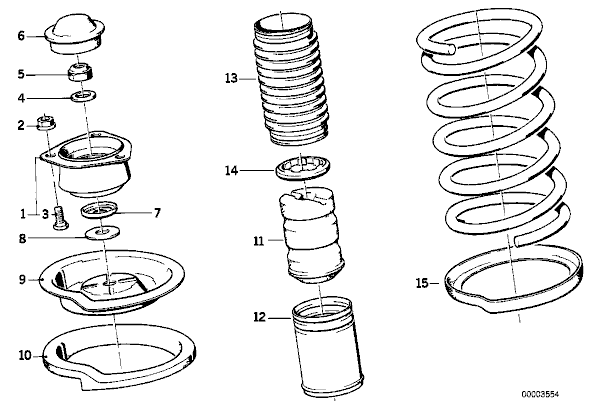

                Can someone tell me exactly how it should go?
                Spring -> Top spring perch -> Washer -> Upper Strut Mount ->strut tower?

                      Spring -> top spring perch -> FLAT WASHER -> THRUST WASHER (looks like a cup, cup should face upwards into strut mount -> upper strut mount -> UPPER FLAT WASHER -> strut top nut

                        Cool, thanks! Out of curiosity, what are pieces 11 and 14? My old shocks that came off didn't have them.

                          Part 11 is a foam bump stop. The E30 M3 bump stop is way shorter in height than the generic bump stop pictured. Sometimes, due to heat, age, or some other environmental condition, the foam crumbles away.
                          Part 14 I think is a collar that secures the accordion boot (part 13), but I think both 13 and 14 are paired only with Bilstein inserts.

                            Just to clarify one more thing so I don't have to do this a third time:
                            The washer bilstein sends with their shocks is # 8 right? And then # 7 is a slightly conical washer and then above # 7 there's a really thin conical bearing cap that is un-pictured that goes on the bottom of the strut bearing, right?
