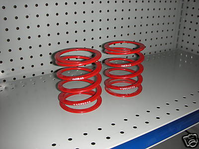

                          The springs on the way are H&R 50lb/in springs-in which case I have to assume they would still be a helper spring as the spring WILL be compressed totally at static ride height. See spring below (these are the actuall springs)\\
                          EDIT: Also the springs in the Vorshlag picture appear to be a higher rate than the black springs in your post....
