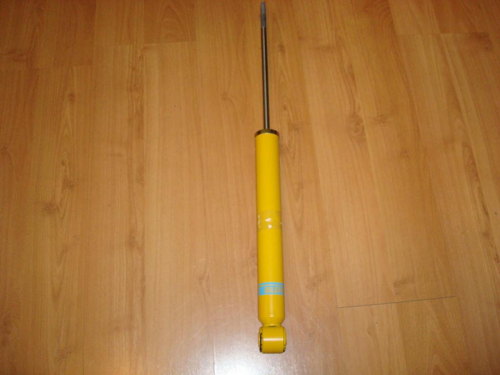

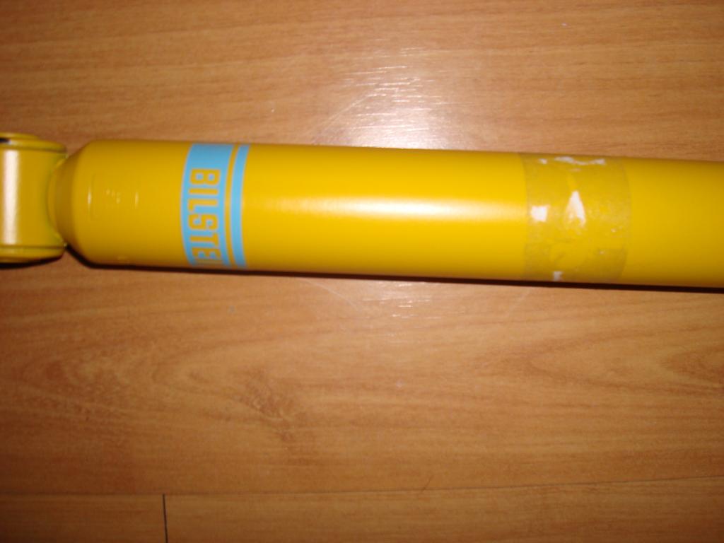

    So I purchased these "Sport Shocks" and i was told they were B36-2027
    but when I received them they didnt have the Item number stickers nor anyway to know on the box..

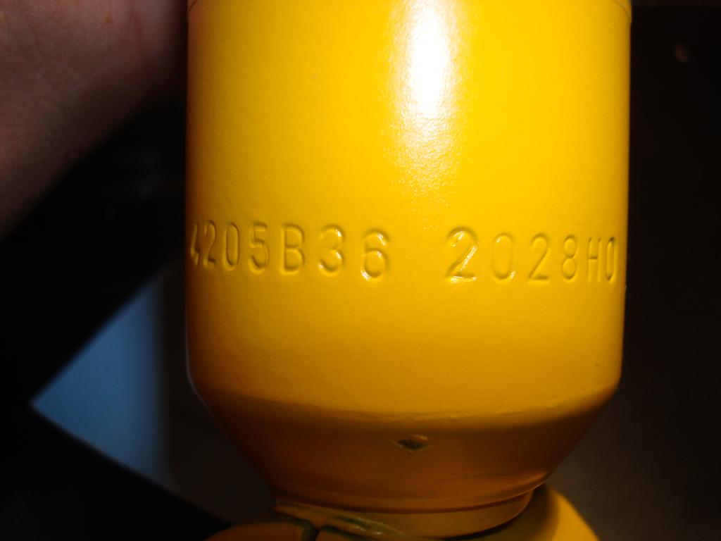

    Just to make sure i looked all around the shocks and found at the very bottem there are these numbers: 420B36 2028H0, thus leading me to believe that these are actually Heavy Duty Shocks item number: B36-2028
    CAN ANYONE HELP ME WITH THIS AND VERIFY WHICH SHOCKS THESE REALLY ARE?
    The Seller had informed me he purchased them through BAVAUTO and that they Confirmed to Him that these were infact B36-2027 sport shocks.
    I have read somewhere that there are two item numbers for sport shocks
    an old item# and a new item#, could this be the confusion?
    Here are some pics:

    Those are B46-2028

          2027 is "sport"
          2028 is "heavy duty"
          the other numbers are for date codes
          the valving is the same, the only difference is the "droop"

            Thanks for REAL help
            Originally posted by Hellabad
            2027 is "sport"
            Jay from GC
            Thanks Hellabad... I thought so .. The reason I had to make this "stupid" looking post was because I was unsure, and i was told by the Seller that these were Sport shocks... The Seller was told by BAVAuto that the shocks he purchased were Sport shocks B36-2027.. again thanks alot for actually helping out and Not being a................................... ASSHOLE--->DSP75<----ASSHOLE
