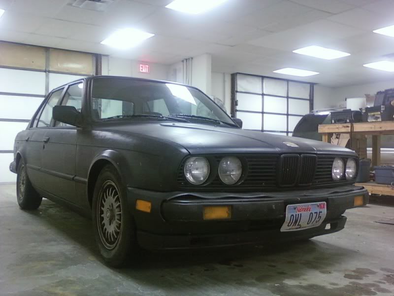

    Here are the before, during, and after pics.
    Before, on stock suspension.
    During, no suspension.
    The drop.
    Install went well, if not long, due to me forgetting to order little things like tierod washers. LOL. Thanks to GotCone? for the help!

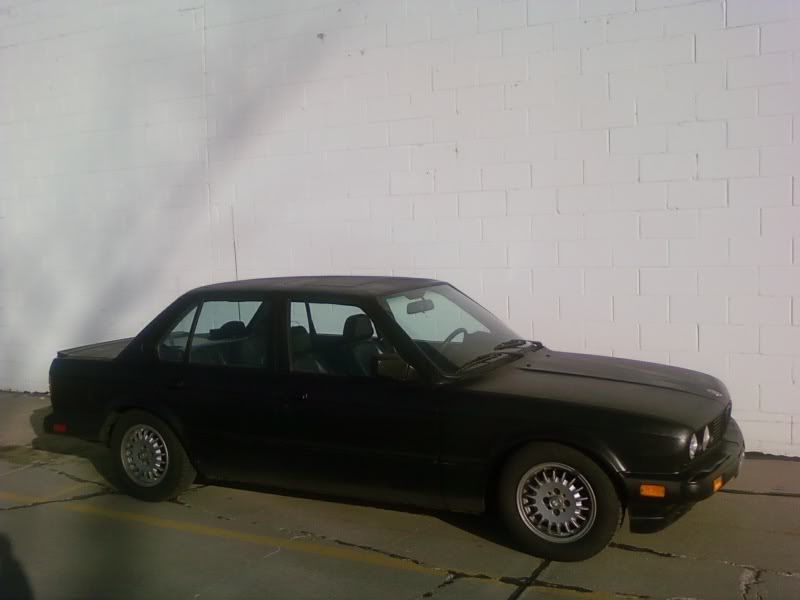

            Got any side shots of the car? :)

              Will get some, as I actually washed the car yesterday.

                Sorry, still crappy cell phone pics.
                For comparision.
                Has a nice rake to it. Was worried, with it being a 318 vs. 328, that the front would rest a little higher. But it doesn't.

                  Is your passenger side high beam full of water?
                  • SpyHunter
                    • 318
                    Laff, yes it is. Not full, but about 2/3rds full. Will be going to the yards soon to find a replacement.
