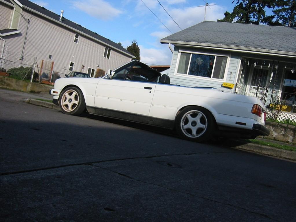

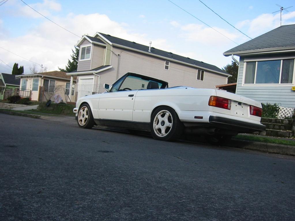

    What are these?
    I've also attached a couple pics of the car so you can see the ride height.

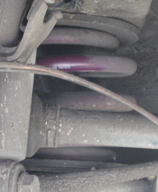

    they look like intrax to me

      That was the initial guess of the people I talked to already, but the writing is white instead of yellow. Not sure if they made versions with white writing as well.

        My guess would be Vogtland.

          Looking at the Vogtland colors, I think that's the closest guess so far. If they are, how much is a used set worth? This is too low for me.

            I just looked closer, they say ATW BMW then have a bunch of other numbers. The rear struts are marked BMW, look BMW, have a roundel, and I believe they may have a part number (going to look in a second). The front springs are obviously not stock, but they're black and rusted with no obvious identifying marks.

              they are not vogtland. it wouldnt be that low. that cabby is slammed.
                that's slammed? :???:

                    So the rear struts are OEM, Sachs. The full text on the rear springs is "ATW pass f. BMW 3/1 HA 701013". I sure hope that doesn't mean someone put what's supposed to be a front passenger spring on the rear driver side corner!

                      Front and rear springs are totally different. Those are rear springs on the back of the car.

                          lolz, yer not slammed, yer frame-scrapping....

                            Here's the translation:
                            Setting lower feathers/springs ATW approx. 35mm 60.00EUR
                            Für eine grössere Darstellung
                            klicken Sie auf das Bild.
                            Setting lower feathers/springs of the mark ATW (of Heyking GmbH) with a setting lower rate of approx. 35mm.
                            Identification VA: BMW 3/1 VA 701010 identification ha: BMW 3/1 HA OF 701013
                            A ABE copy is provided. According to ABE the feathers/springs are only for the 320i, 323i, to use 325e and 324D. Fit do they however for every different one also, except 325ix.
                            Used, good condition.

                              Could these be OEM? That's crazy that they're paired with OEM struts...
