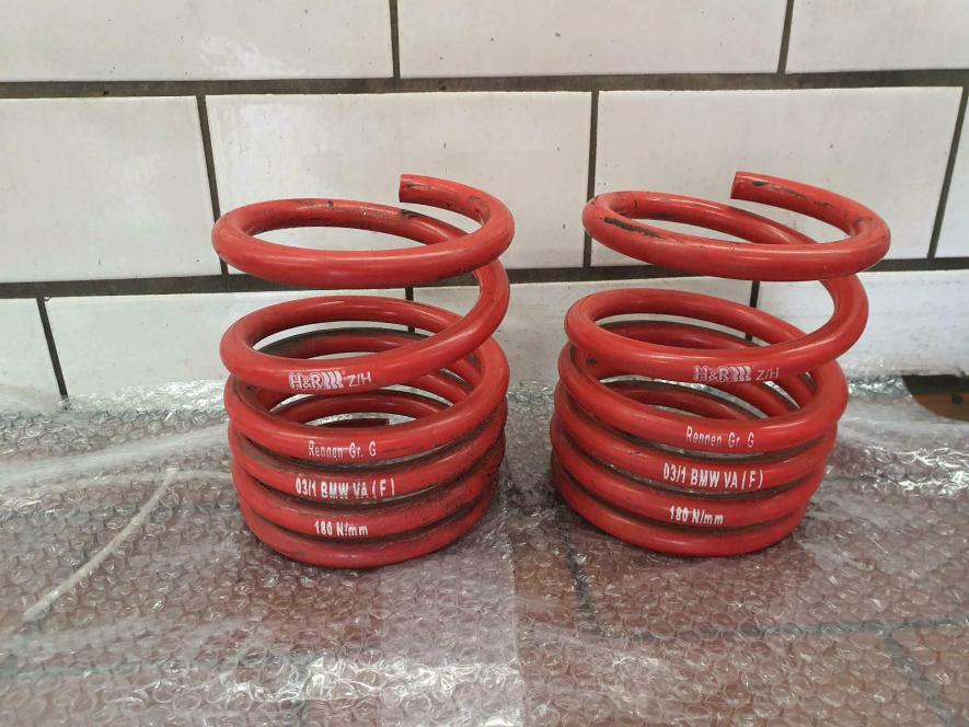

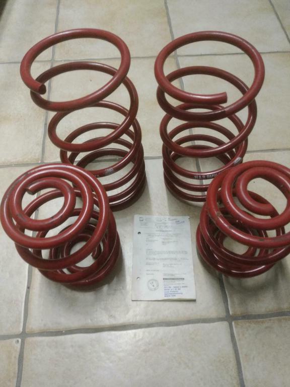

    I was looking into springs and saw these images (a German online used market website).
    Looking closely, the "progressive" part of the spring(s) are at the bottom of the strut housing. Those two springs are technically the same, but here in EU H&R renamed them and repainted them (for some unknown reason) but the technical data sheet is the same (same thickness of the coils, uncompressed height etc).
    The springs i have, despite them being 100% technically the same, are basically "flipped over". Meaning the progressive part is at the top, when one comes to read the H&R markings. I installed them, in that order, meaning one could read the H&R markings and the progressive part on the top (not the bottom as shown in the pictures). Even the used H&R Group G springs i found, have the progressive part at the bottom (when one reads the H&R markings) as shown in the last picture.
    My question is, since i had the progressive coils at the TOP, have i installed them incorrectly? should i "flip them around"? i can not find any concrete answers and please bear in mind, in EU we do NOT have H&R OE, Sport and Super Sport. We had the 19.01/19.03 springs that were renamed and replaced by the 29664-1.

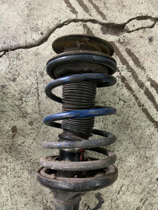

    Here's a shot of the orientation of my 50404-55s installed:
    Bottom line - as long as they in the lower spring pad pocket and upper retainer correctly, it shouldn't matter what direction the springs are installed.

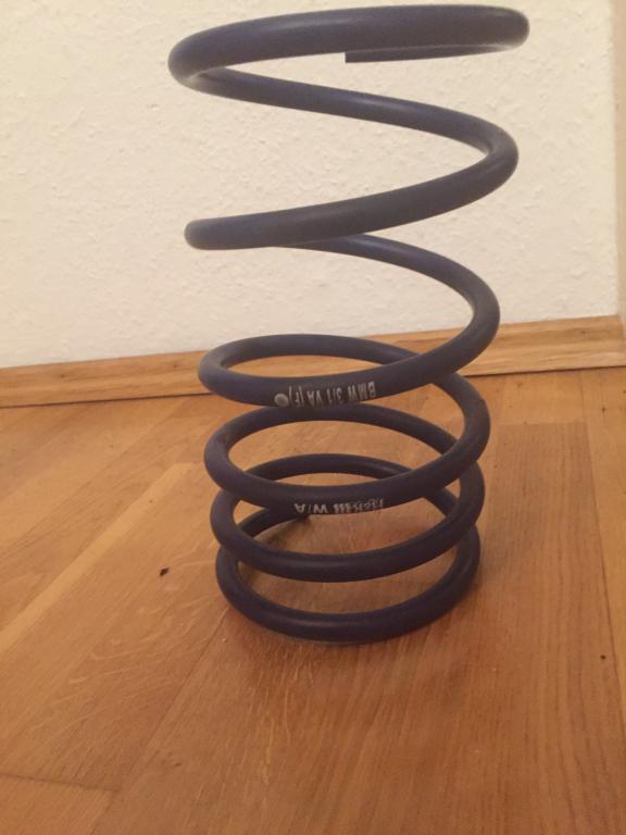

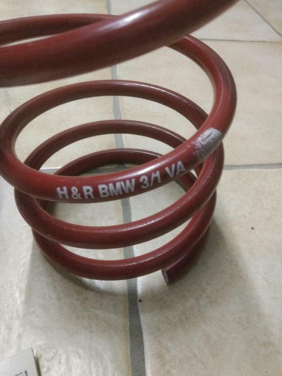

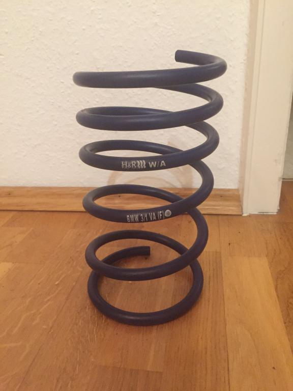

      Thank you Mike, but i am still on the fence regarding the orientation. Take a look at my springs.
      The first picture shows, how the progression part (otherwise known as a "soft part) is facing up (just like yours) and one can read the H&R lettering.
      The second picture shows when i flip it upside down (soft part down) and so is the lettering.
      Comparing those with how the earlier pictures i uploaded are orientated, it is confusing. I have removed the front struts around 5-6 times, swapping springs and replacing top mounts (horrible play on brand new parts) and despite that, switching from B8s to B4s made very little drifference. It feels as if the front end is a go kart with bilsteins. Regardless, i always make sure, that the spring ends are snug up against both upper and lower spring pad shoulders.
      Regarding spring rates, again it MAYBE a US thing, since H&R claimed to me that "we would never offer aftermarket springs with a significant higher spring rate than the factory springs, either the same or 10% stiffer). So it got me thinking, maybe i installed them upside down?

            I managed to install the springs, with the progressive side facing down (upside down lettering) along with new upper and lower spring pads and new mounts from BMW. I also threw in the M-Tech bump stops (again from BMW) and the car is a lot better like this.
            It no longer "crashes" on every surface imperfection, it is still a very firm ride, only big road issues cause a "crash".
            Sadly, the roads i drive on locally, and when i move to munich, are just falling apart. You are correct, these 29664-1 springs are just too firm for daily use, even with the B4s (and M-tech 20mm front/14.5mm rear sway bars). No doubt that, these springs would be great for track days, the front end feels like it is glued to the asphalt, full confidence and control, but my current roads and my regular driving, i need something softer.

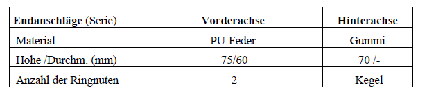

            The thing that i noticed, and you may find interesting, is the technical spec sheet, the one we require to give to the TÜV when renewing the registration.
            Seems that the Eibach E2003-140 kit is around 10mm higher (uncompressed) than the H&R ones in the front, while the rears are the same.
            Also the E2003-140 kit also recommends using the 75mm bump stop (the M-Tech one) and NOT the standard 85mm one.
            I printed out the documents from Eibach and will drive by my TÜV and inquire, if by installing these Eibach springs, do i still get the Historic plates (it is some German thing they do here) or not. If i get the green light (which i should) i shall be swapping the springs.
            My only concern is the front hight, since they are a bit higher than the H&R ones, i am wondering if i should get the E90 drop hats to "balance" it out or not.
