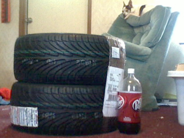

                      215/40/16
                      this is nexen 215/40/16.
                      There re two of them stacking together. Hope u can see how width of one is.
                      ( hope they stretched well )
