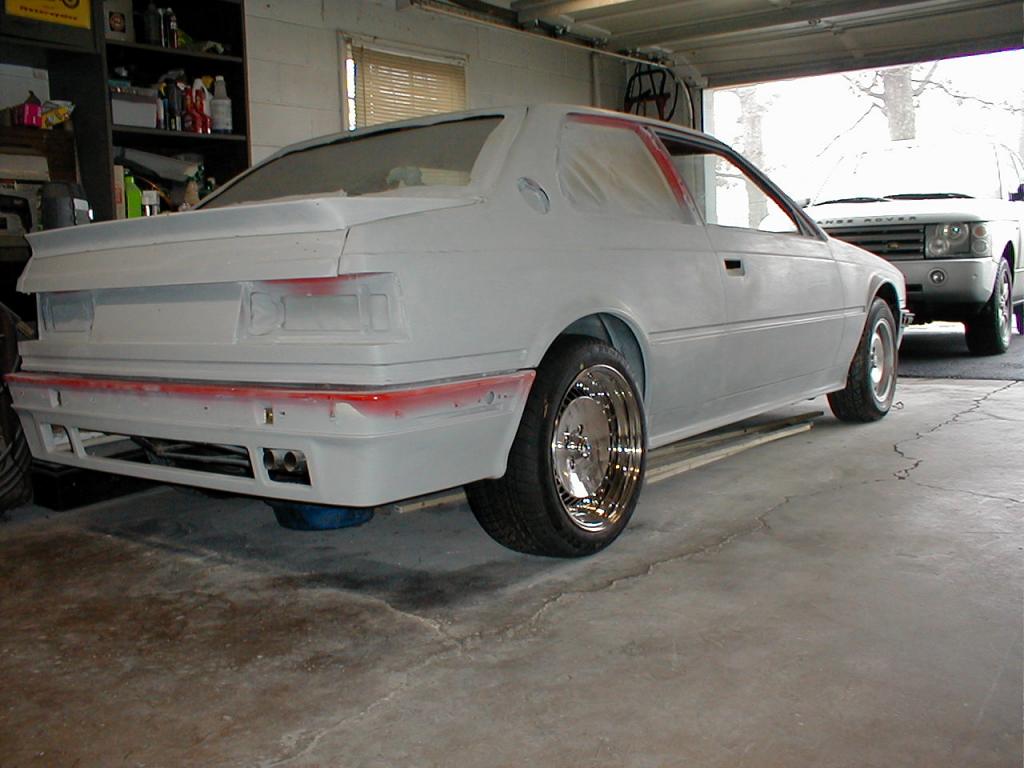

    I attached a pic of the Biturbo because I'm uber proud of it. It will be lowered after paint. It has a custom set of GC coilovers with Konis.

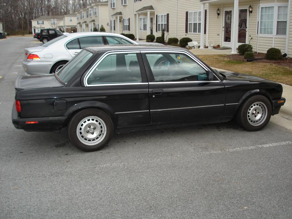

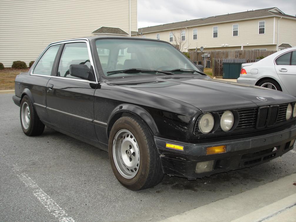

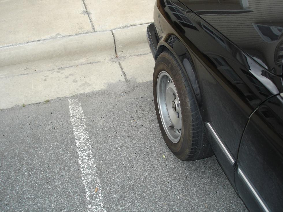

                        Fitted...
                        In case any of you were wondering how this all worked out, well it was quite the adventure. I had researched the wheels and made sure all of my calculations were correct before I made the 6 hour drive up north to switch the wheels. When I got the wheels I was in for quite the surprise.
                        Everything I read about the Biturbo wheels said that they were 14x6, et11 and 6 respectively. I even found a shot of someone who had the wheels mounted on an E30. Problem is that I was researching the wrong wheels. My Biturbo is not your standard early car nightmare. It is actually an Si, meaning that it was built with fuel injection, slightly different interior and guess what? Different wheels. The wheels on my car were actually 4x98, 14x7 et0. In addition, the bolting area was too deep for the wobble bolts to penetrate and get a safe grip. In addition, the hubcentric rings were completely out of the question. What was a guy to do?
                        The answer was to make my own hubcentric rings (58.6-57.1) out of copper to center the wheels. We then used the factory bolts from the Maserati (I had new ones for the Schmdts) and bolted them up. Althought I am not crazy about the poke in the front, it will have to do for now. To make sure all is well down the road I have ordered a lug conversion with wobble nuts. After a 6 hour drive with no vibration and no loss of torque in the lug nuts I am pleased to say that the car is better off now. I will need to invest in some camber plates for the front to fix the poke, but I want a set that lowers the car a little as well so that's my next purchase.

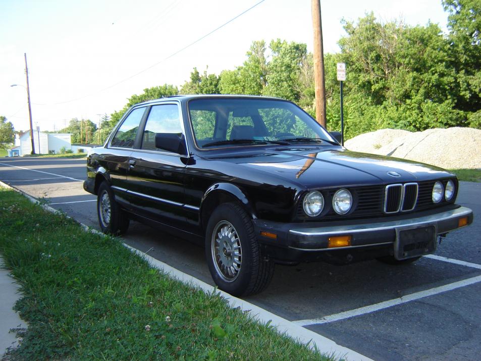

                        I will have to use an old before picture but the result speaks for itself. Thanks for looking and furthermore thanks for all of the help!
