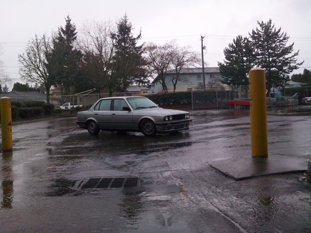

    I've reached the time to get some wheels for my automobile, and would like your guys' imput
    Im currently rolling on the 14" stock steelies, and wanna get some 16" dished wheels (ie: Type As, Keskin kt1 etc..) but im worried about rubbing. what kind of offset should i look for so it sits flush or maybe tuckin a little bit? Im riding on a non adjustable H&R cupkit, so adjusting the height is kind of out of the questions. Also, wheel suggestions are welcome :)

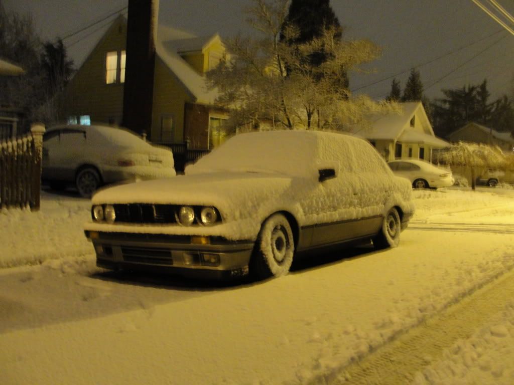

    some pics of my car for refrence:

        16x9
        front et10
        rear et15
        16x8
        et15 to et25ish
        Those should get you close. You could be a little more flush if you want, but probably need stiffer suspension to keep from rubbing (plus roll and/or tuck). If you find a wheel that is close you can always use spacers.

          16x8et15 is not going to be flush. also run the rear at a lower offset if you want it to look right.
          Roll your fenders
